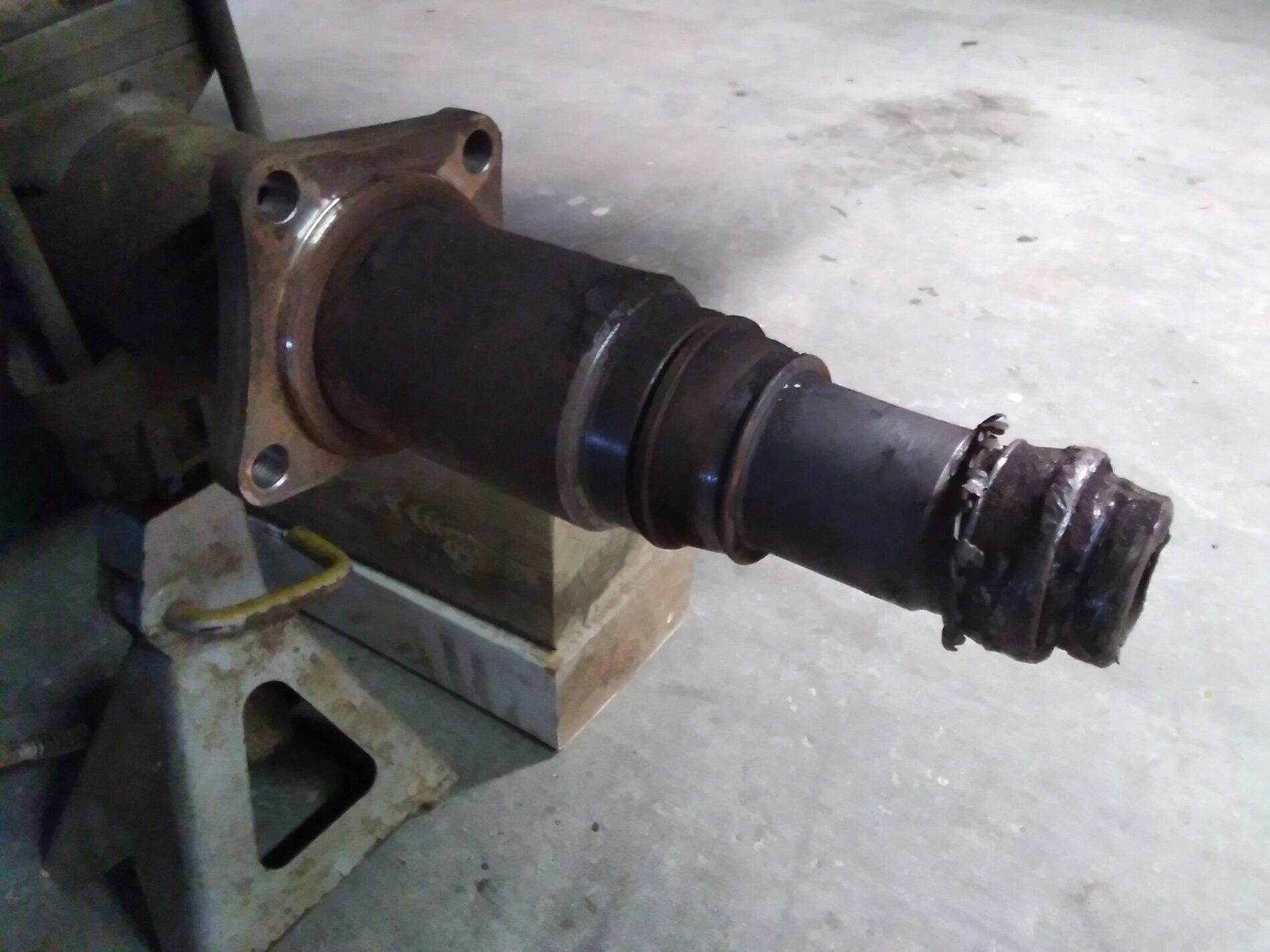

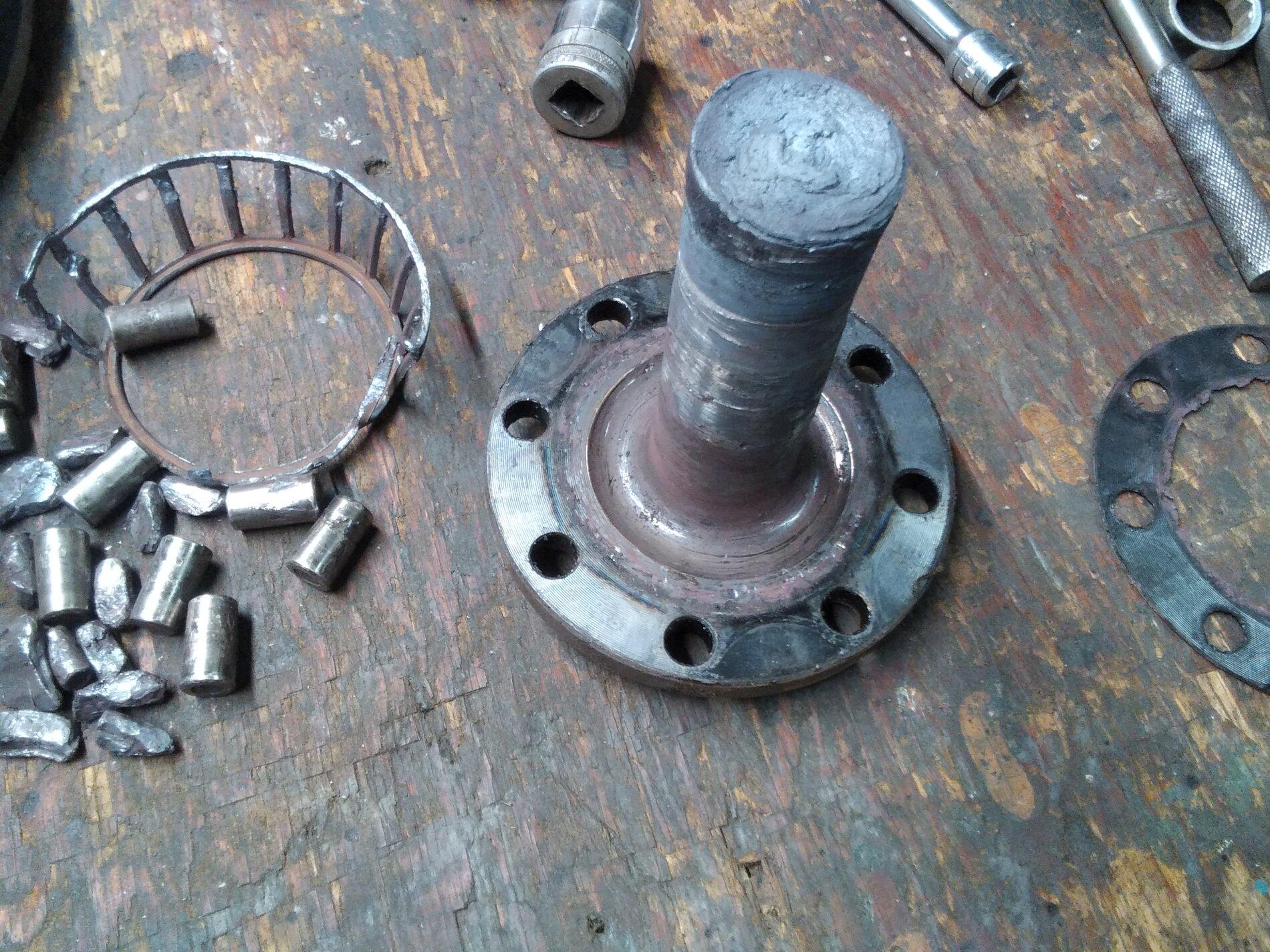

My Dad sent me these pictures of his 2001 3500, auto, disc brake, rear axle.
Now I have so many questions...
Over tight bearings/lack of lube led heat, to hub nut coming loose, to bearing destruction, to axle breaking?
^regardless, 2001-2001 disc brake axles are hard to find and expensive. What axle housings will swap in?
Will disc brake hub bolt on to 3500 drum axle?
Will 3500 disc hub bolt onto 2500 disc axle?
Are V-8, V-10, D80 housings the same?

I don't have the specs in front of me, but I think the axle shafts are the same on the D80 duallies… a quick measure of overall length and a quick comparison would tell you if they'll swap. I think they're all 35 spline. As for what caused that, I'd say lack of quality lubricant. The wear in the races points to it running roughly for quite a while, dictating a lack of oil. That's a pretty serious failure, and should have given quite a bit of warning.

JMcCoy, yes the housing was torn up, zero threads remaining on stub for wheel bearing/hub nut to attach to.

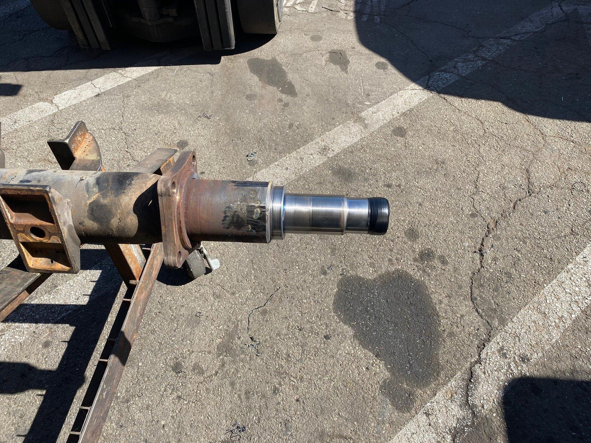

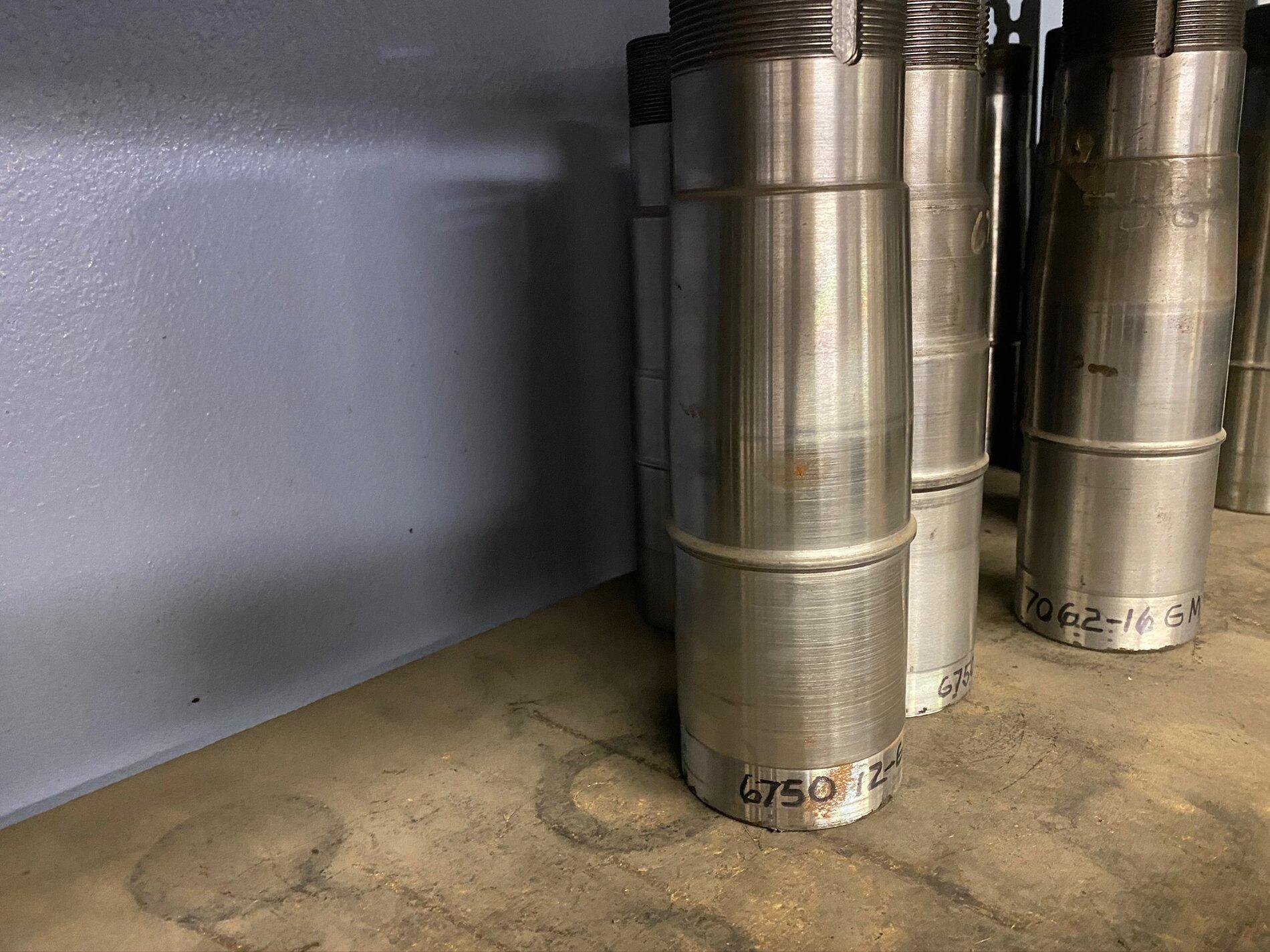

Junk yard axle housing was bent beyond being able to be straightened. Searching harder for options I found Axle Al in Ontario, CA. They were able to cut off spindle, turn axle tube, press in new spindle.
Bent axle sent back, axle repair was cheapest than used axle, dads on road and happy.

It's great to hear you got good results from an axle surgeon. I've heard about pros like that. It takes some serious skill to be able to repair a spindle so badly destroyed, as your dads was and to be able to do it on the truck without removing the entire differential. wow. Comon that's total rock star performance and skill.
Agree with other posts on this thread, keep an eye on your oil level. An axle shaft does not suddenly shear off for no reason. It's blue and weakened from heat. It must have given some warning noise and grinding. The failed bearing caused the axle shaft to heat up.
I would be leery of doing such axle repairs while its still on the truck because axle alignment is critical for bearing wear and longevity. For this reason, when doing anything extensive which involves removing or moving bearing surfaces then its best to remove the differential and all internal components and use a jig to assure everything remains aligned. In a pinch if you're stranded on the road is acceptable but certainly not what I'd suggest as normal...
