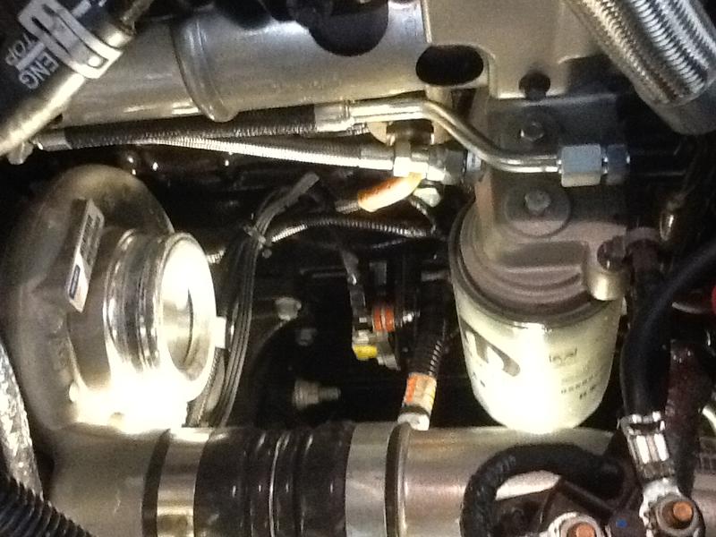

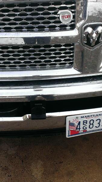

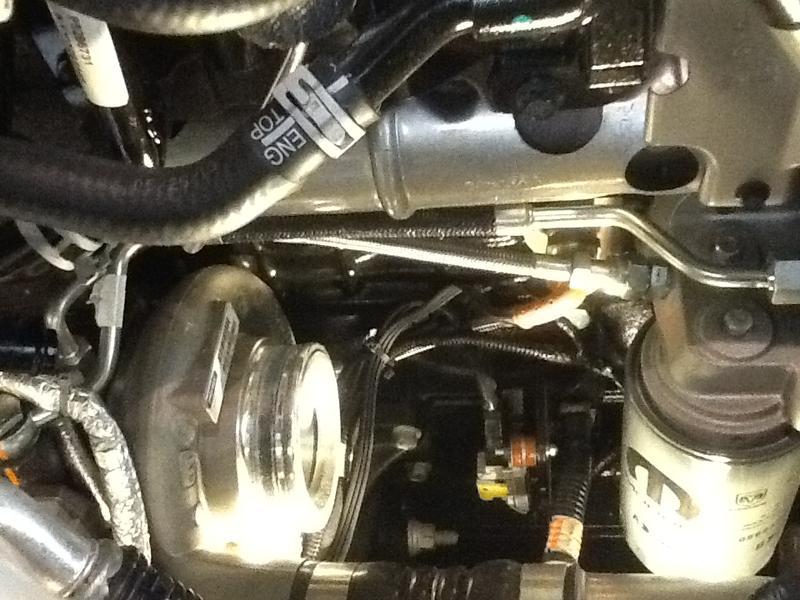

Here's some pictures of mine, from there I just ran it along the hoses nice and loose like up to the right side tow hook. Hardest part was getting it over the smaller radiator hose and tighten the wire time there to hold it I'm place.
