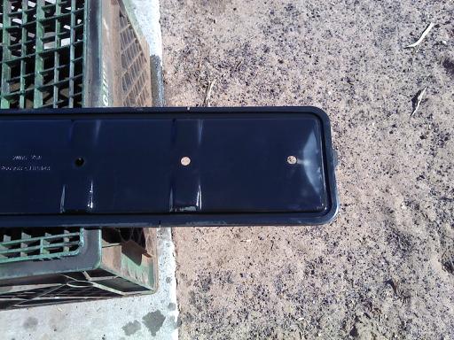

If it is original than it is pretty much not a surprise that it may need replacing. I am getting after several repairs. The Tappet cover had rust on the outside edge under some of the old (and brittle) gasket. So I hit it with a scotchbrite pad on a air sander and got rid of most of the corrosion. I then painted a good coat of high zinc frame paint on it from Eastwood. The inside looked new of course.
