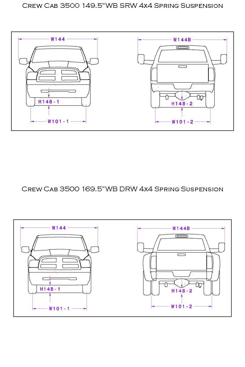

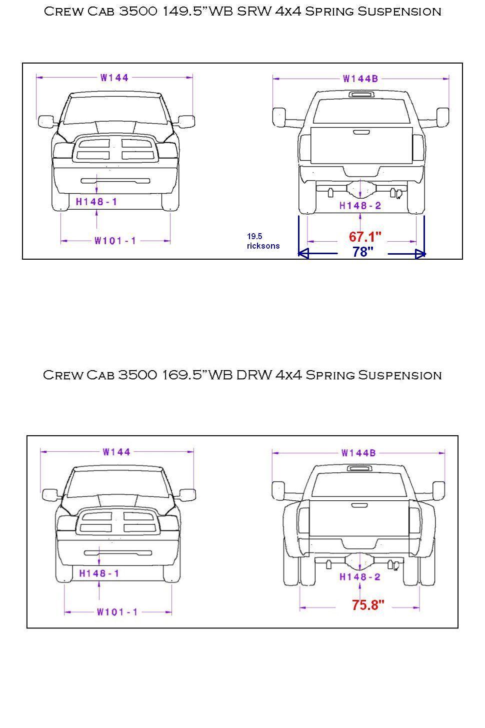

opened up this again as I am reconsidering the conversion.Heres something interesting( to me, you guys already probably know it);
the rear tire centerline dimension of a srw is the same as the between the tires centerline of a drw
