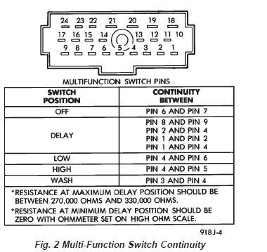

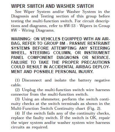

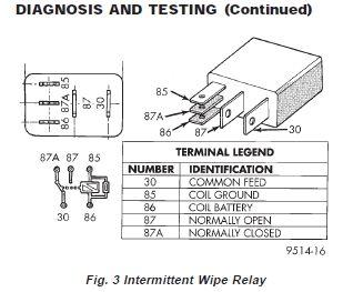

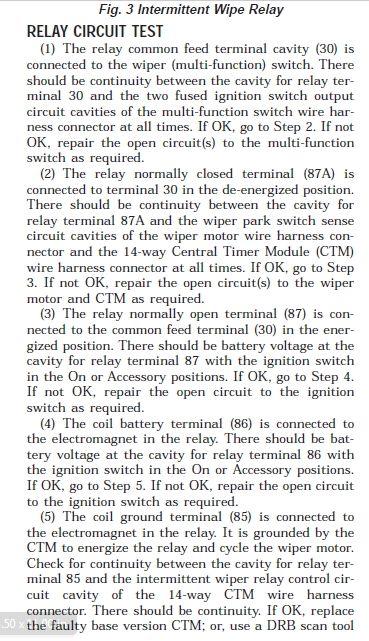

Info 8K-6 and 7

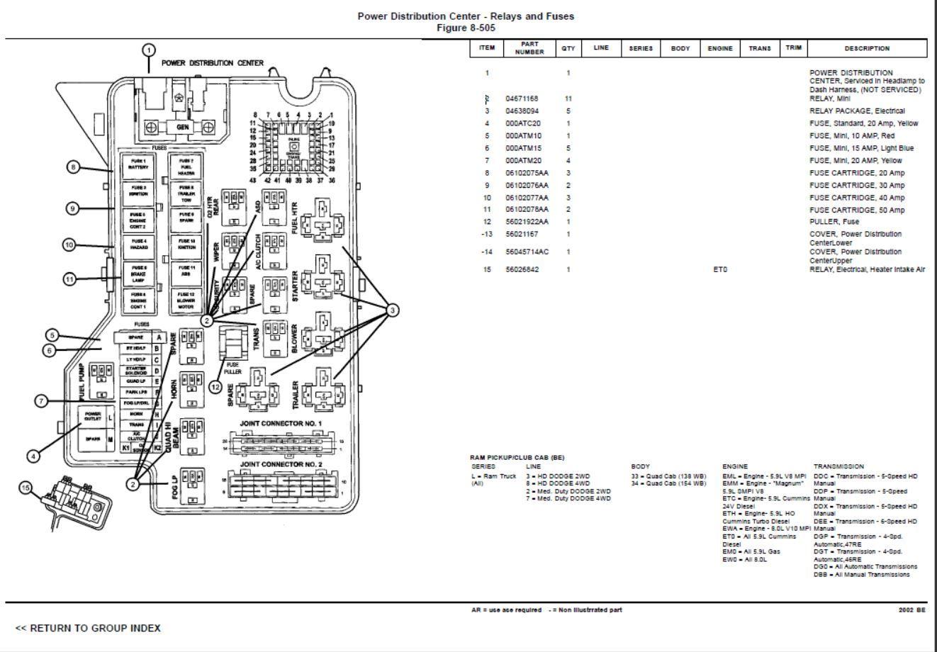

Easiest first step would be swap out the wiper relay in the PDC with another similar relay from the PDC.

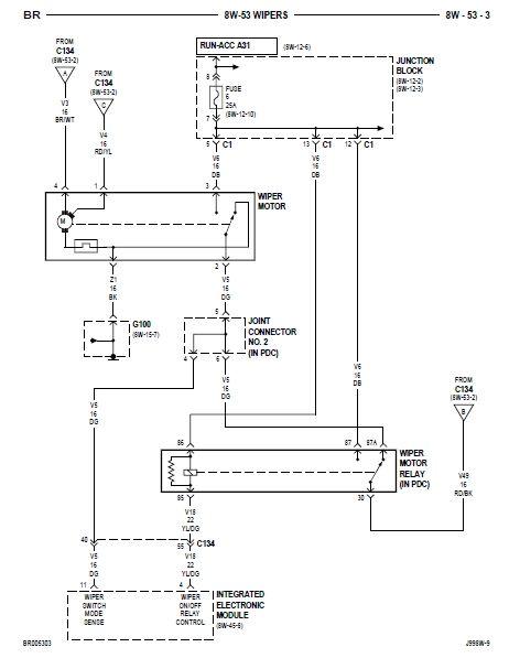

Looking at the wiring schematic in a little more detail the relay is the most likely culprit. It would supply the park voltage after the intermittent signal starts the motor rotation. The motor and relay positions determine the activation of the park circuit. The symptoms you are experiencing are indicators that the park cycle in the intermittent mode is not being activated. I still would not rule out 100% on the multi-function switch or CTM.

Hmmm. I don't think the relay controls the delay function; those relays (of the same size/footprint) are all interchangeable, so it's easy to test.
The CTM should only power the wiper long enough to get it started; the motor should have an internal circuit to power itself until it reaches 'home'. Note the diodes in the diagram; they're a strong hint that voltage/current from the motor must needs be blocked.
I suspect the culprit is the wiper motor because only the motor itself knows 'where' it is and when to stop. It almost certainly has internal low-tech 'rotary' circuitry to keep the motor powered until it reaches 'home'. If your wipers 'hide away' (park) behind the hood, there's a separate circuit and internal control to make the wipers do this. If you open the wiper motor, you'll likely find that the contact surface that keeps the motor powered until it reaches 'home' has a break in it that causes the wiper to stop mid-stroke.
