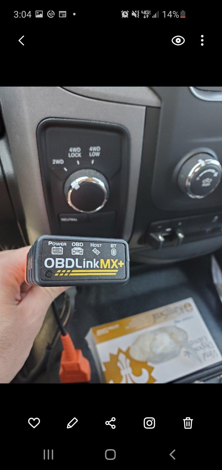

My $9.95 generic works exactly the same as the MX+ I purchased for AlfaOBD. I thought it was my generic dongle at first, but it turns out I was not waiting long enough after each change. I wasted the $89 for the MX+.

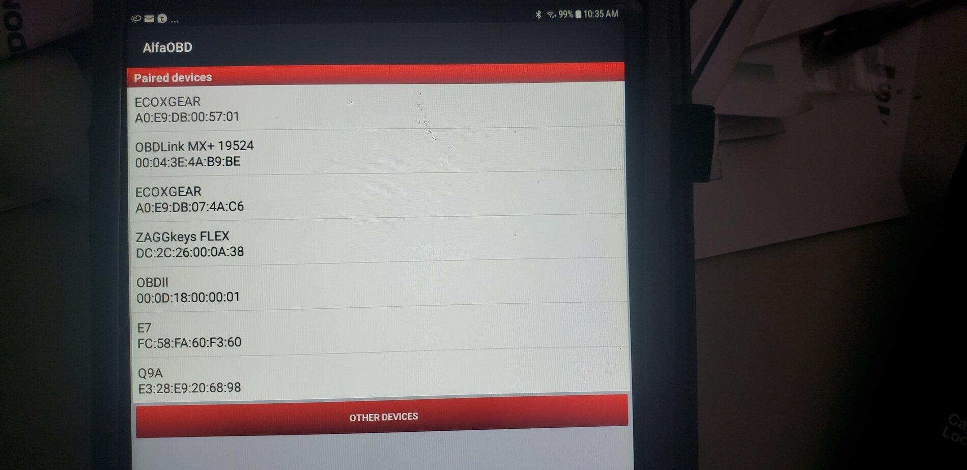

Do you use apple or Android. And if you use android; which dongle do you choose in the alfaOBD app?
Did you FIRST go into Android Bluetooth settings and pair MX+? That step is required before AlfaOBD will see the MX+. You only have to do that once.
After that the MX+ has been paired it will be available for AlfaOBD to use. Then in AlfaOBD choose OBDLink MX+ as your device.
I was successful pairing the device. And I used to use the torque app with a bafx dongle, so I have done it before with a different app and different dongle
In the android version I downloaded, there is no MX+ option.
Edit: it did say it was paired. And did say it was connected. But it wouldn't read anything

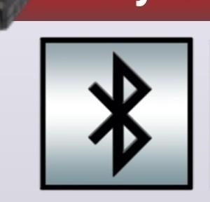

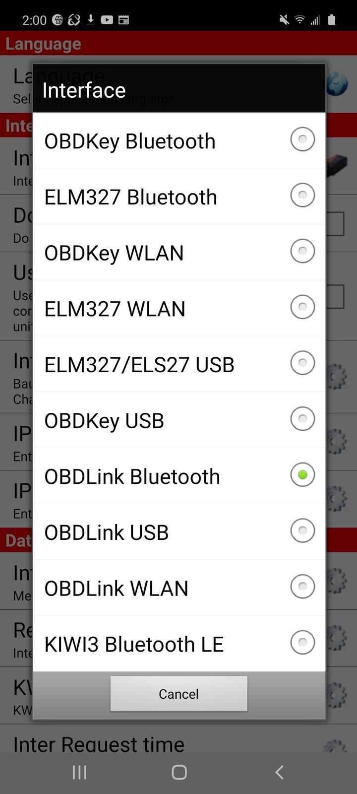

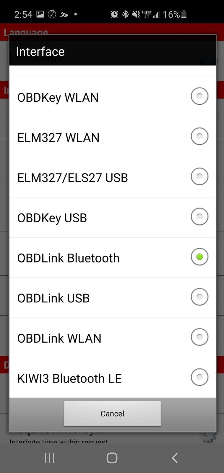

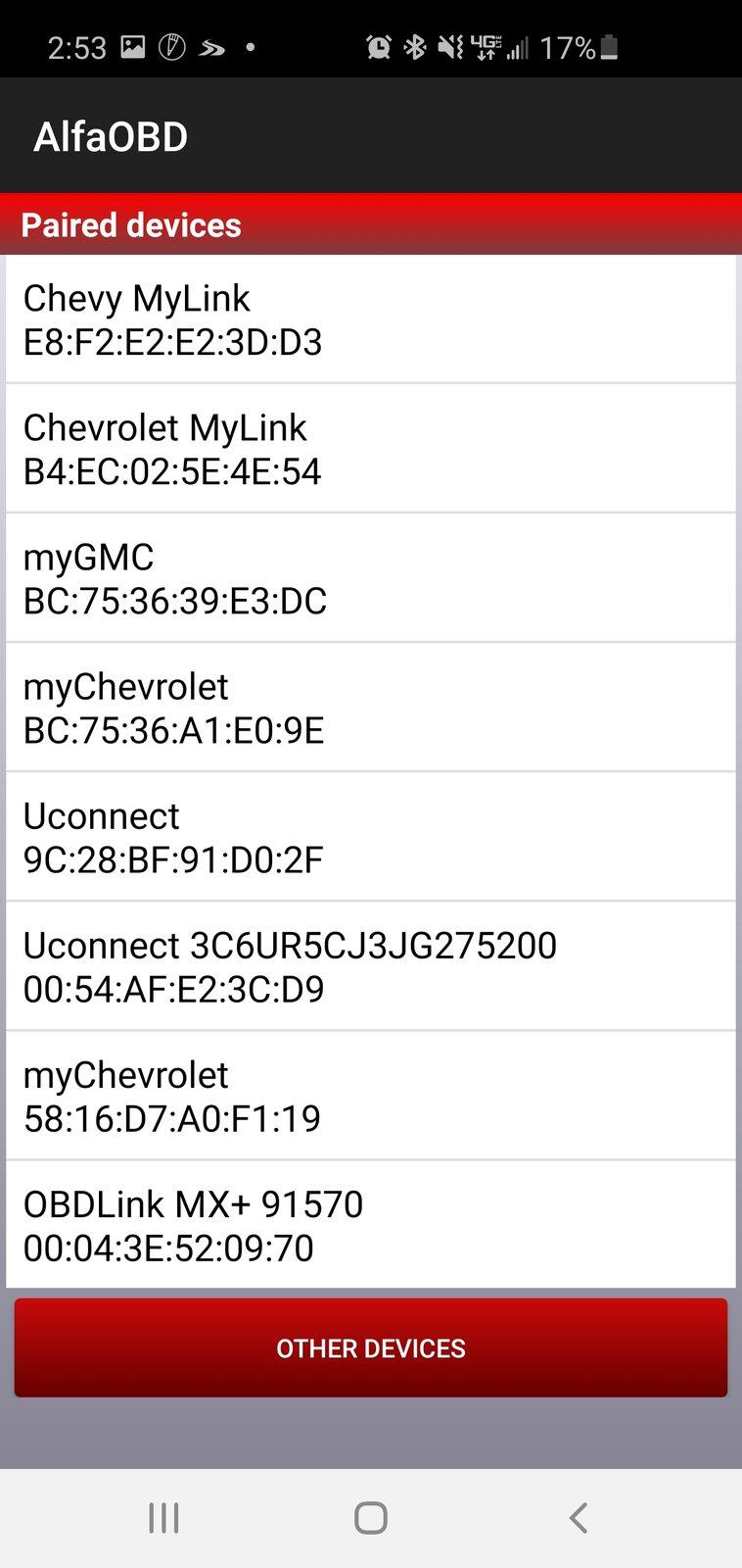

I see the issue between our two photo. It is the method you are using to choose the interface. There are two methods.
1. clicking the BlueTooth emblem on the My Interface section of the home page. That will bring up the list I showed. This is the option I use.
2. Clicking "Preferences->Interface->Interface" Will bring up a list you show. That list doesn't specifically say MX+ in the name. I don't normally use this option but I think you want to choose OBDLink Bluetooth.

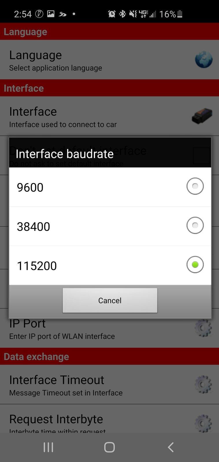

I picked the same set up you had the baud rate was set at 115kbd that's a standard setting for the bus.
But yeah no issues.

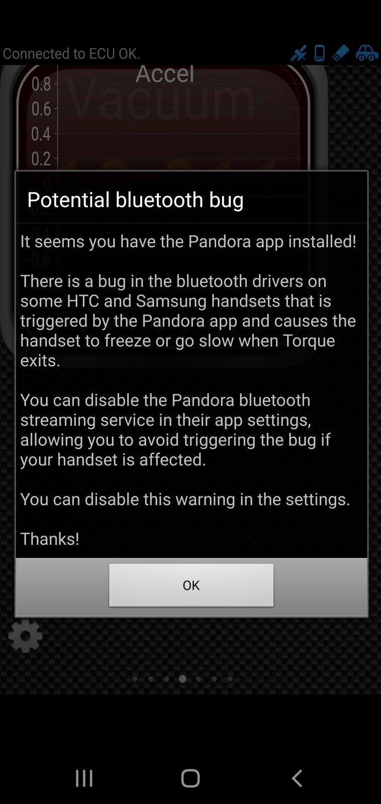

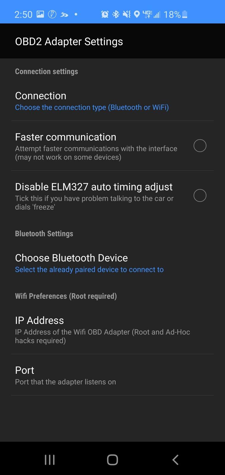

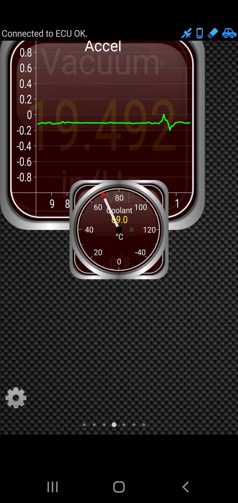

I also tried the torque lite its not made for
my phone but worked fine even with all that there were some funky warning from the app.
Hey you did press the Bluetooth button from the AlphaOBD app to.select Bluetooth?
At the top where it says my interfaces?

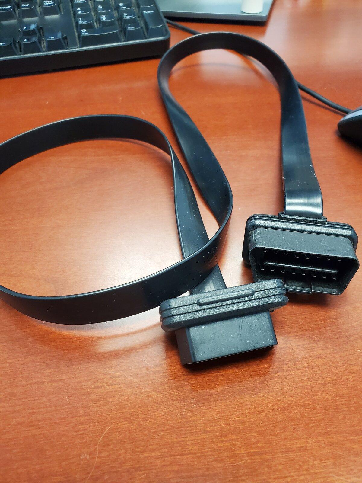

Another good thing to have to save you from climbing under the dash is an cheap extension cable, these trucks are pretty easy to get too, but the smaller vans and cars can be tough to climb under I find the ext. Cable works great if you plan on doing some work over a few days.

I actually detached my OBD2 connector in my truck and tie wrapped it under it the dash and Edge CST2 monitor cable routed from A pillar through the dash to it. I'm going to order OBD2 Y cable to see if CST2 AND MX+ will work together.
I had moved the OBD2 connector so I would not hit it with anything plugged in.
