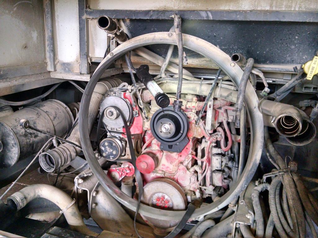

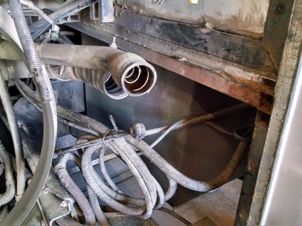

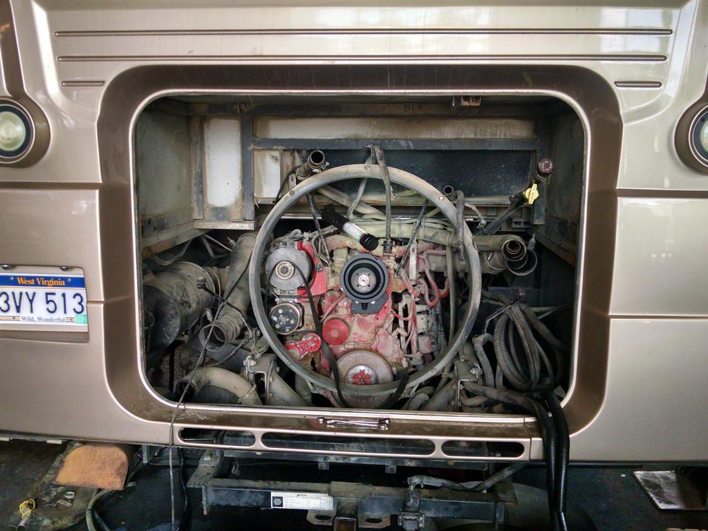

Here's some food for thought, just walked by this one in the shop.
Simple fan hub replacement, not. Al least the radiator will come out through the rear opening, some will not if you can believe it.

Regarding Mike's photos above, I was always told that if I were to buy a Class A, get one with the side cooling pack for any number of reasons - fouling, access to engine, etc.

MWilson also raises a point - one picture worth a thousand words.
Rusty
The side cooling pack does allow for better access but some of the fan drive systems leave a lot to be desired. I'm all for the belt drive with the directional converter box as the big coaches use but have seen nothing but trouble with the PTO driven hydraulic fans.
