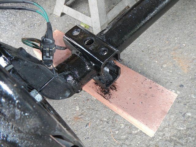

Also, when the grounding began to happen, it was intermittent, and near impossible to isolate (and certainly invisible being inside the axle tubes), so on the re-wire I got water proof connector sets (similar to vehicle OEM type plugs), have a connector for each drum brake, so I can individually isolate for trouble shooting if needed, also I can isolate the wire in the axle tube, so future isolation of problems are possible on the road, worse case I pull the plugs for an axle, and retain at least one axle, way better than no brakes at all. As originally configured, all the brake magnets are hardwired together, one fails, you lose them all, and can't even check by meter to find which of the 4 (or more) are bad unless a wire is cut.. just not a good design at all.

Oh, one more mention, consider a waterproof connector set for each drum.. this way in future you can individually troublshoot a bad magnet, and on the road isolate it, so you at least have SOME brakes, not the all or nothing that the permanent connectors will offer.. you simply can't figure out which wheel is bad if you can't connect/disconnect them one at a time. Given what I know about the wire in axle tube grounding issue, I also added a connector to isolate that too if needed.. but avoid this and direct wire as TLane suggests and you'll be better off for sure.

Picture shows the waterproof connector for each drum brake that I installed.
Here is a link to the connectors I used, good price, you do have to assemble them as they come as a bag of parts, but it is pretty obvious how they go together....
