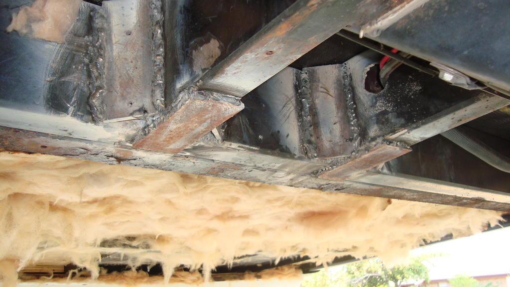

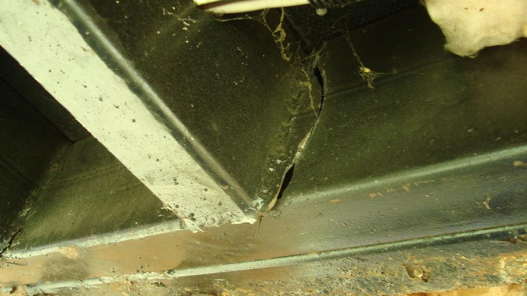

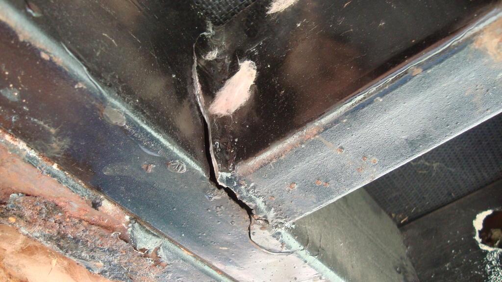

Frankly, the axles don't concern me as much as Lippert frames do. This is our old Monaco 5er after about 12 years of ownership. It always had flex in the frame, but then the flex became so obvious a camper asked me about it after I had parked the rig in NY. I blew it off, and towed it home, by way of the Blue Ridge Parkway. The guy's remark nagged at me though, so I pulled the bottom panel that covered the hitch framework.
Two fore & aft beams.
No more flex.

Your pictures of frame cracks are sobering (to say the least). I'll need to keep an eye out.
