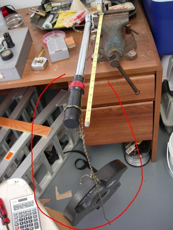

This is a simple method to see what your TW reads. There are better methods out there [check youtube], but I used what was available.
Bench Vise; Measuring Tape; Masking Tape; 25# & 45# weight [not a dumbbell] borrowed from a relative's local fitness club; Parachute Cord [aka 550 Cord]; Calculator. Also used: piece of cardboard and cloth to protect the square drive.
1. Pick a spot on the handle of your TW. Measure distance from the midpoint of the square drive to this spot. Mine was 19". Line up the edge of the tape on one side of mark or the other. [I just put tape in the center of my spot with a pen marking off the distance. However, the tape gets beat up from the testing, so it's best not to have your cordage rest on the tape.]
2. Set your TW according to the following formula:
...Torque = Distance x Weight. Since I dealt in foot-pounds: Distance = 19"/12" per foot. Weight = 25#. Torque = 1.58ft x 25# = 39.5ft# --> sets TW to 40ft#.
3. Secure the TW in the vise. Protect the square drive. I tried using a sacrificial socket, but it will turn in the vise.
4. Tie the weight with your cordage and then proceed to gently hang the weight at the spot you picked on your TW. Lower the weight very slowly else you'll set off the 'click' in the TW [false positive]. With the weight hanging from the handle, note whether or not your TW made the 'click'. Adjust TW & repeat until you find the point where it clicks.
Now you can see if you are on target, high, or low!
5. Change weight. 45# --> 71ft# of torque [@ 19"].
6. Change weight. 70# (combining both weights) --> 111ft#.
Is your TW consistent? I hope so, for now you know how your TW performs.

In the pic, the tape had torn, so I removed it. The camera angle also makes it look like the weight is touching a nearby box -- it did not.

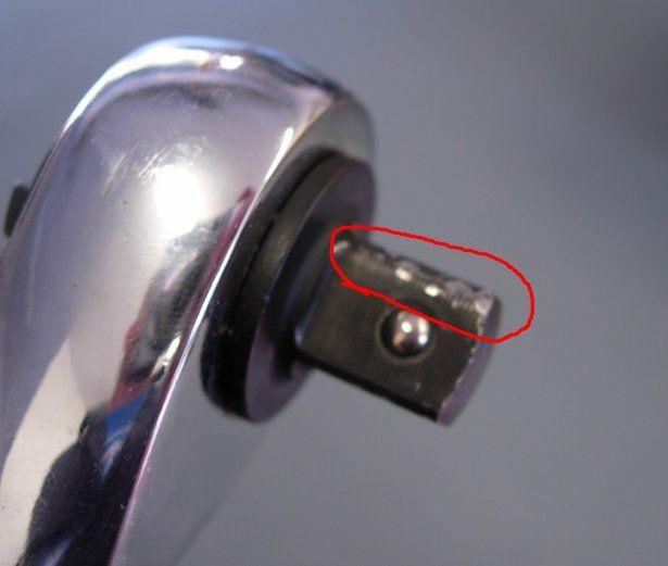

I slightly marred the surface of the square drive. In the pic above [post #1], you'll notice that I didn't use a piece of cardboard along with the cloth. Ooops. [It still accepts sockets alright.]
I used cardboard [along with cloth] with my 3/8" drive TW, and that did fine. YMMV, of course. Hence the 'disclaimer'!

My 1/2" drive Craftsman 150ft# {2yrs old, mild use, stored at lowest setting} was consistently ~6% high. This means that everything I've fastened with it has a lower value than what I desired. From now on, I can set the TW to 6% more than what the manual specifies, and I'll be right on target.
My 3/8" drive Tekton 80ft# {same stats} was not consistent, except that all the TW values were lower than expected. 8% low @ 25#. 4% low @ 45#. 10% low @ 70#. This means I've over torqued the bolts. 10% doesn't bother me much, and now that I know I can compensate for its inaccuracy.
