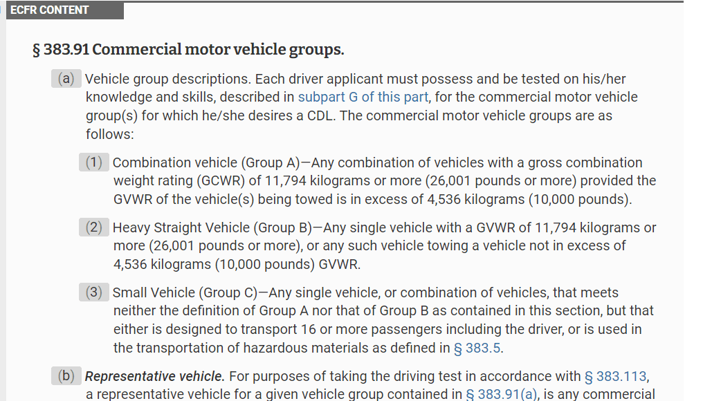

From the FMCSA Web E-CFR documents:
As I read it, I wonder do our 3500 trucks fall under the Class A requirement?

One of the reasons I stuck with my '97 while hauling trailers is it's 10,500 lb GVWR. I could hook up to trailers up to 15,500 and not need a CDL-A. So the answer to your question is yes. If your GCWR exceeds 26,000 you need a class A drivers license. If you are using it commercially you need a CDL-A. Some states exempt RVs but many require a class A for the big ones. TX and PA have non-commercial class A drivers licenses but a lot of states require a CDL-A even though the rigs are not "commercial". CA has a requirement for a CDL-A for all non RV trailers over 10,000 GVWR regardless of the GVWR of the tow vehicle and their non-commercial class A is for RVs over 15,000 GVWR, again regardless of the tow vehicle. Bottom line is check with your state's DMV. My info came from official state DMV sites but do your own research. The forums are not the correct place to get legal advice.
