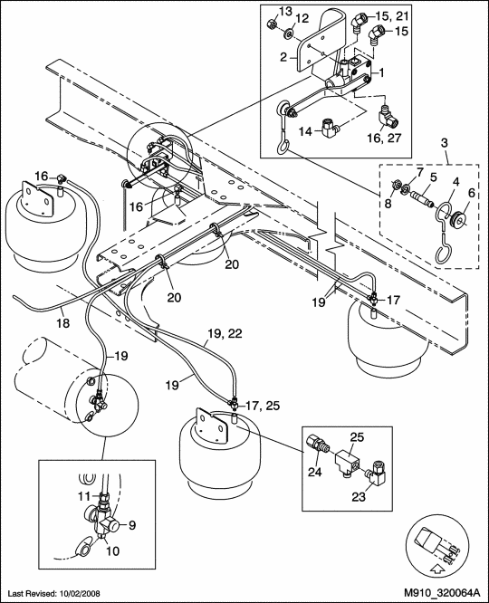

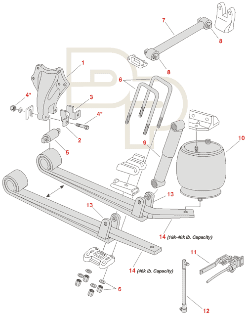

So here is a graphic, 46,000 Freightliner Air-Liner suspension. All bags are tied together.
If the tipping was a real issue there would be trucks laying upside down on every corner. I don't disagree that individual bag control would have it's advantages with a slide in but it is not mandatory.

The big difference I see between the Freightliner and our trucks is that we use the airbags as a supplement, and not the main load carrying spring. In addition what size is the air line on the FL?
Like I said all the negative feedback I have received on airbags (personal, not internet based) has been from common plumbing. There is no way around the flow.
On a 3rd gen without an OEM rear anti-sway bar it would be even worse, IMHO.
Plumbing is 1/4" plastic air line. Kenworth's latest generation air ride uses steel tubing with at least 5/8" ID.
I'm not an engineer and have a hard time trying to explain what I know from firsthand experience.
There has to be a point where the bag can't compress any more under the load with a set air pressure and stops moving even with another bag on the opposite side tied to it.
The Freightliner system still adheres to the same principle and it is a hybrid, there is a spring with each bag.

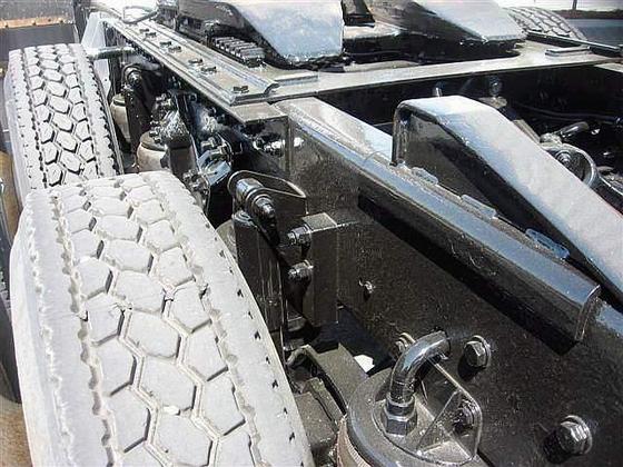

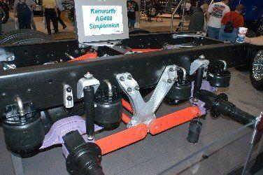

Just for grins here are a few pictures of the KW/Pete 8 bag air ride.
Check out the size of those lines on top of the bags, that suspension must react instantly to anything.
Or the lines act as a "ping tank" of sorts, there would be quite a reserve between 8 of those lines
Mike.
When KW came out with the 8 bag (looked different than the pictures) it was a seat pucker BIG TIME. Went for a ride with a guy that had it I was getting ready to open the door and jump cause I knew that it was going to roll. Pete's Air Leaf is what I had and loved that suspension. I have a single axle Air Leaf on the international rides nice even on a MDT
