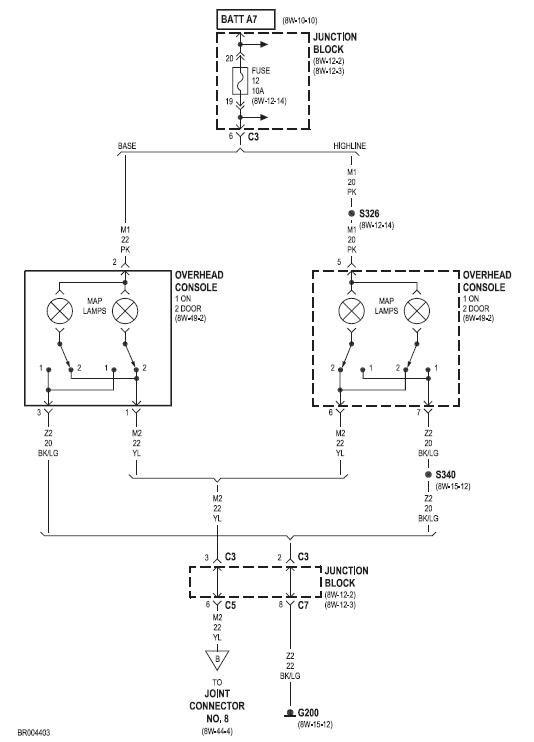

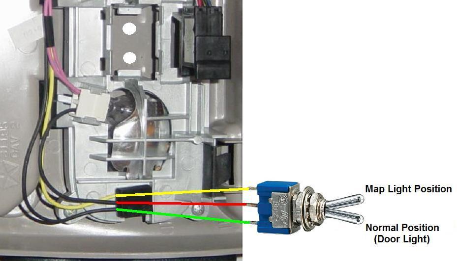

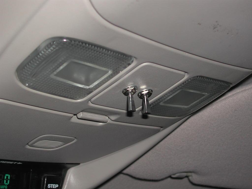

My switches broke. I wired in a couple toggle switches. I guess this doesn't disable the light completely when opening the door, but according to the schematic, if you don't connect the door wire, it might - and only work when you flip the toggle.
Maybe - instead of using a 2 pole switch like I did, use a 3 pole switch. One direction lets the door lights to work, center position turns everything (the door circuit) off, the other position turns on the map light w/doors closed. So you will have the option of using the light with door open if you want.
