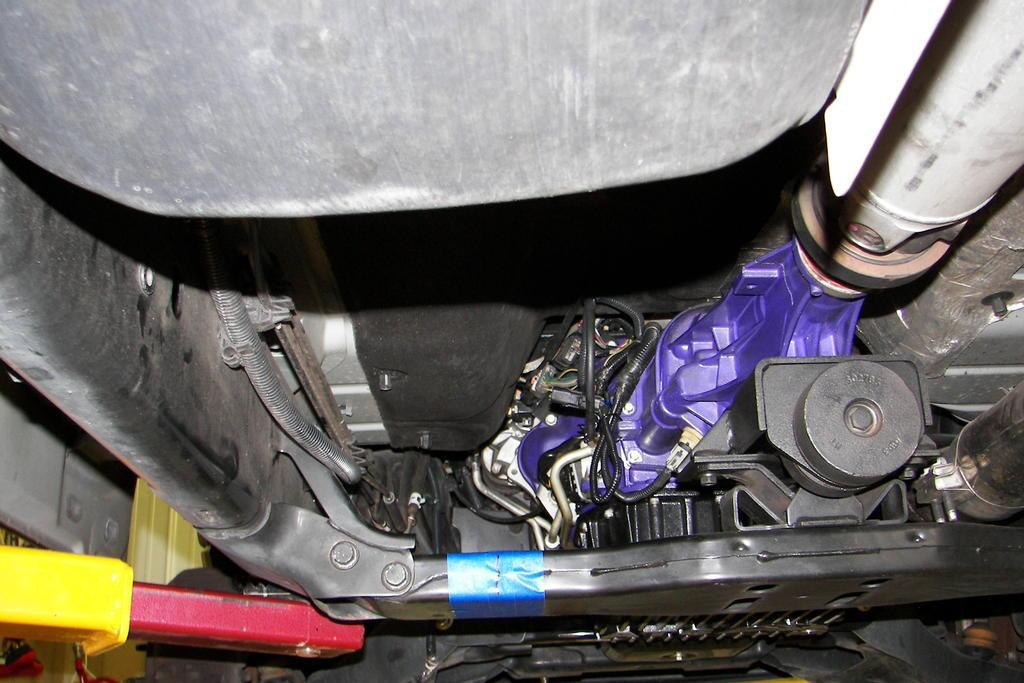

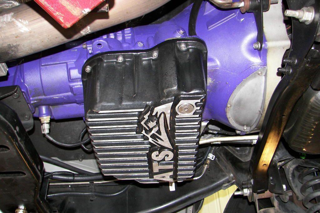

Just for a point of reference I have a 2WD 2004.5 QC and mine has the deep ATS deep pan which I think is the same depth. It clears the cross member fine and doesn't hang down as far as the cross member.
Also I removed the 2 spacers in the rear leaf spring packs which lowered the rear end of the truck about 1 inch. I never had any problems even going through my pasture.
For what it's worth.
