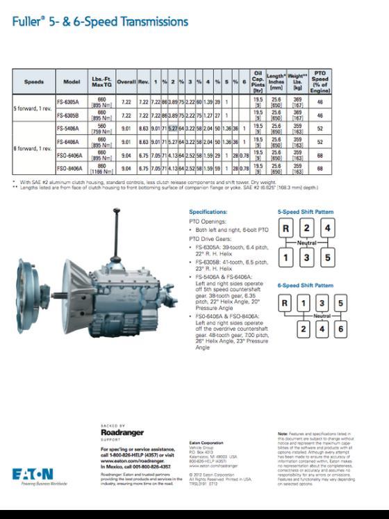

Our trucks might be capable of converting to this transmission.

What about an Eaton manual like an 8 speed?. Should be a med. Duty manual out there to work with the 6. 7... .
Interestingly, every part in the G56 that I saw had an "EATON" stamp on it. The input shaft, main shaft, countershaft, and what few gears I could see well... ... Apparently the casing is the only part that is not Eaton..... :cool:
