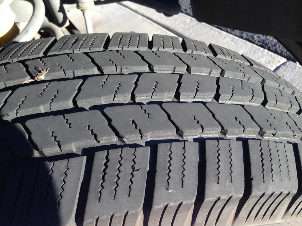

I have noticed my 2014 dually is wearing the outsides of the front tires pretty bad, especially the drivers side.
With just 34k miles on it, would the dealer fix alignment under warranty or should I just take it to my local alignment shop?
Anyone else notice this kind of tire wear on their dually?
If your front tires are wearing on the edges, its more than likely just from turning. Maybe you are turning more to the right causing the left side tire to wear. I have a fleet of about 125 3/4 & 1 ton trucks that do a lot of turning on a military installation, believe me they wear the fronts out way faster than the rear. I do a lot of rotations. I'm not saying your front end is out, but if you do a considerable amount of in town driving, this is more than likely the issue. But if you feel better about an alignment I doubt the dealer will warranty something like that
When turning sharp or driving in curvy conditions, you will wear the outside edges on the front tires. I have experienced this on all 4 of my Rams over the past 12 years. Tire rotation will help considerably. I rotate every 7,500 miles.
My 2014 showed a lot of wear on the outside of the right steer.. The dealer aligned it under warantee at 23k miles, Changed the castor some? But I will have a good alignment done when I put new tires on it!!
Duallies can be prone to funny tire wear all around. When turning sharp, the rear tires flex sideways and can even slide a bit sideways.
Duallies try to track straight because of the 4 rear tires. So it requires a bit more turning force on the front tires to pivot those back tires.
If you do alot of turning on pavement, it is normal to have uneven wear on a dually.

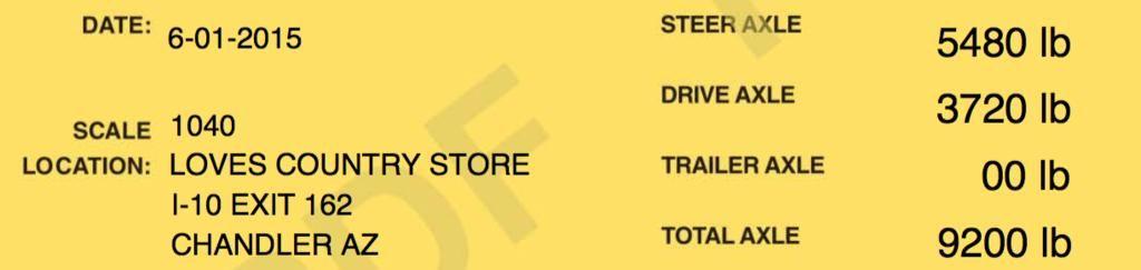

As they say this ain't my first rodeo! Just look at the weight that is on these new truck tires. My front axle with RV attached is 5,440#. If you look at the weight chart it recommends for something around 70psi but add 10 psi to that and you will get better tire wear to compensate for turning.
Honestly even with 80 psi in the front on my new 15 it's not enough air. I wish they had a direct replacement that had more carrying capacity. I guarantee the edges will be worn out before the centers for sure!
"80psi in the front full time might wear out the center section of your tires."
Very true Cummins... I just weighed my front axle yesterday, empty was like 5,200 lbs! Interesting enough, on my old 3/4 ton diesel I ran the front tires at about 70 - 80 PSI as well... That is a heavy hunk of iron between the frame rails!
Another thing to remember is once a tire starts a wear pattern, it won't correct itself, by changing tire pressure, alignment specs, or even the load.
Mine started showing the same pattern of wear. I don't rotate the rears, my second dually. I rotated the fronts at about 20K by taking the tires off the rims and putting the outsides on the inside and placed them on the opposite side of the truck. The tire shop thought I was nuts but they want to sell more tires.

The guy at Americas tires wanted to argue with me yesterday when I told him I wanted the front rims to remain where they are because of the sensors. I told him to move each front tire side to side so the inside of each tire will be on the outside on each side. In other works I wanted toe tires to be rotating the same way just swapped side to side. That way the scalloped wages will average out.
He told me he was going to charge me $24 to do this. I said why as I am not asking for a full rotation. After explaining my warranty covers me to have every tire broken down from the rim and re balanced he said OK no charge.
