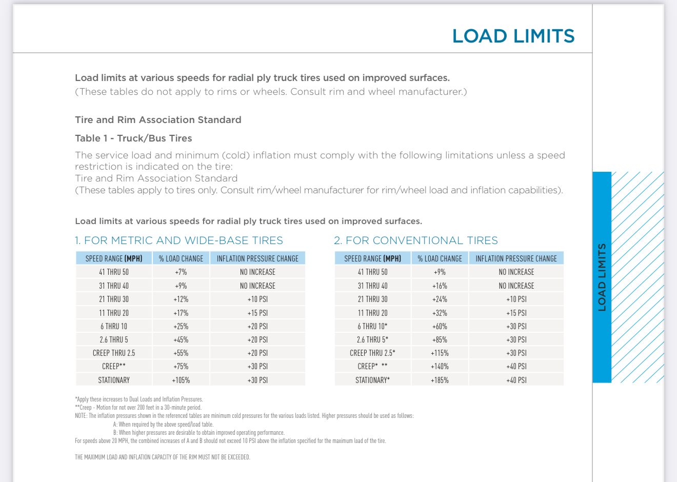

Back before tires were speed rated, the manuals would tell you to add 10psi for extended high speed running. For truck/bus tires there was also a load rating decrease above certain speeds (usually 75mph). With speed rated tires the pressure and load rating changes are factored in to the speed and load ratings so no changes are required.
Toyo has this in their commercial tire. … and we shouldn’t even get into LT vs ST ratings a margins ;)

Where do I find these load charts? I search and all I get is max psi is 80.
Her is a link to the Toyo site that provides that info.
https://www.toyotires.com/tires-101/tire-load-and-inflation-tables/
Same info from Falken Tires
https://www.falkentire.com/load-inflation
There are some differences in 17" LT tires from the two sites. This is due to the fact that at one time TRA limited 17" tires to 3195lbs. If you have a 17" you need to verify which is the correct table to use by looking at the max load for your tire.

I don't know for sure that they changed but I would believe they have because the Falken Wildpeak AT3W which is a new design now has 17" tires listed as high as 3970lb. When TRA brought in the 3195lb limit they grandfathered old designs to the higher limits so I'm guessing that since the new Wildpeak is back to the higher limits TRA has changed the requirement.
Interesting, I do recall some tires never adapting the limits while other tires changed over quickly without even redesigning the tire.
It’s been a long time since I’ve shopped 17” tires though
Quick search on discount tire website for a LT285/75R17 comes up about 50/50 index 121(3195) and index 128(3970). The 128 rated ones are newer designs like BFG KO3, Falken AT4W and Toyo R/T with the 121 rated being older designs like Toye AT3 and Nitto Ridge Grappler.
