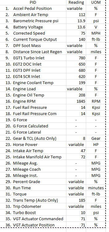

Patty, I have a test Edge unit that we will reprogram when it is returned to me next week. In the meantime I would certainly like to see the fields that are allowed and, if you have data, the numbers that you are seeing.

Robert here is a list of the available fields and the readings I was seeing while travelling at 75 MPH, 44*F outside temperature. Some of the read-outs obviously fluctuate depending on topography, wind, etc but this gives you an idea. Hopefully the attachment works.
Hopefully the attachment works...
Yes, it is on the EcoDiesel and works like a charm!
