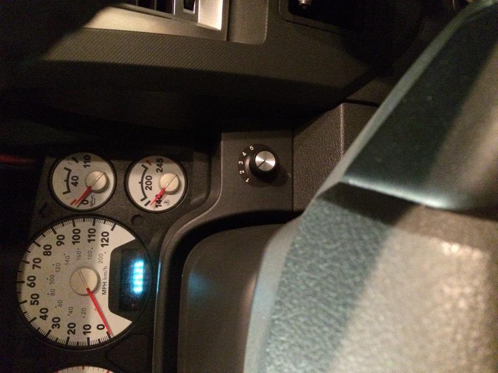

BTW, I installed the CSP5 selector switch at a location only I can reach and would be hard for the passenger to mess with, just in case someone got the earge to turn it, or my wife not realizing what she's switching.(She is always changing things without telling me what she's doing)
