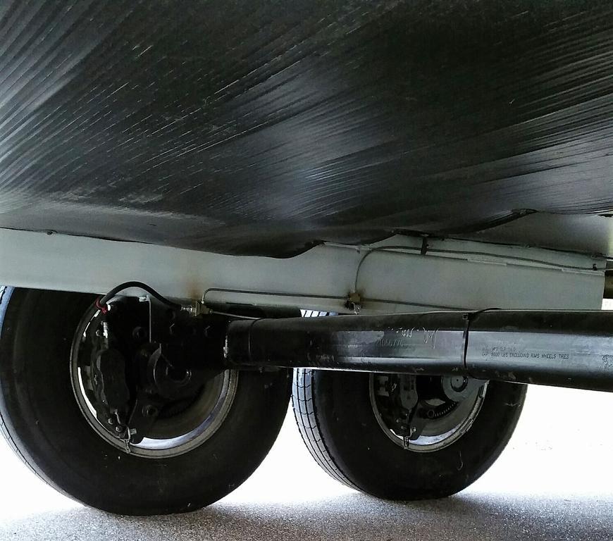

About a year ago I had my 7K axles with electric brakes replaced with Dexter 8K, independent suspension, never lube bearings and hydraulic disc brakes.
The trailer is in my signature. I've towed about 5000 miles since then and it's day and night difference. My factory E Brake still does most of the work but when I step on the brake it stops as good as an empty truck. I can't see any wear on the pads yet.
Ron,
Once those are completely bled, you have massive brakes. That was my issue and it caused a slight delay, I got rid of the air bubble and delay is almost imperceptible.
The one watch out for item is the dust boots, if they get tore up then water can get in and rust follows followed by possible piston to housing sticking and a hot rotor. Happened to me. I came up with my "repair procedure" and so far, so great.

I had it done at a custom trailer builder here in MN. They did a complete job including brake pump, wiring, new G rated tires. They do quite a few of these, only took a couple of days after the parts came in. I had them do lifts on previous fifth wheels and knew that they did excellent work. They will build you a trailer from scratch or almost any kind of modification you can think of.
It's not inexpensive but my trailer is almost like new, inside and out. My wife and I were trying to decide between a new trailer or rebuild the worn out suspension on the current one. The quality of a HitchHiker trailer is pretty good and something of similar quality today is quite expensive.
We decided on a rebuild. It cost a little over $9000 including tax. That was a 3 inch lift, independent suspension 8K axles with never lube bearings and disc brakes, new Goodyear made in USA G rated tires, Dexter hydraulic brake pump and wiring, all the brake lines, brake pump mounted inside custom welded aluminum box to contain the fluid in case of leaks and all lines bled and road tested before they gave it to me.
