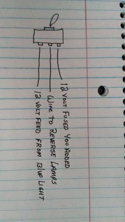

After a bit of thought the easiest way will be to purchase a different switch. I will draw a schematic after a bit more coffee....
I will add to this after attaching the picture from my phone. Drawn after only one cup of coffee..
So now I can type without squinting. Where you have already cut the wire I suggest my method above instead of a relay set-up.
Cut the wire under the truck that you spliced into, leave your newly installed "Load" wire attached to the wire going to the reverse lights. Verify that you have the right wire by putting truck in reverse, key on. Make sure that you have power coming through the wire from the b/up light switch. If so, turn key off and make sure that there no power. That will verify that you do indeed have the correct wire. Bring that wire into the cab along with the "Load" wire that you have already added.
You need a switch like I referenced above, you can get a three position which will give you the added feature of no reverse lights at all when in the center position or a two position without the center off feature.
You need the following switch description...
Two position SPDT on-on
Three position SPDT on-off-on

I would still use my method so the factory wiring before your splice does not get a back feed. Something else may be upstream.
If you still want an indicator you could use a DPDT switch and control an indicator light or two with the extra terminals.
