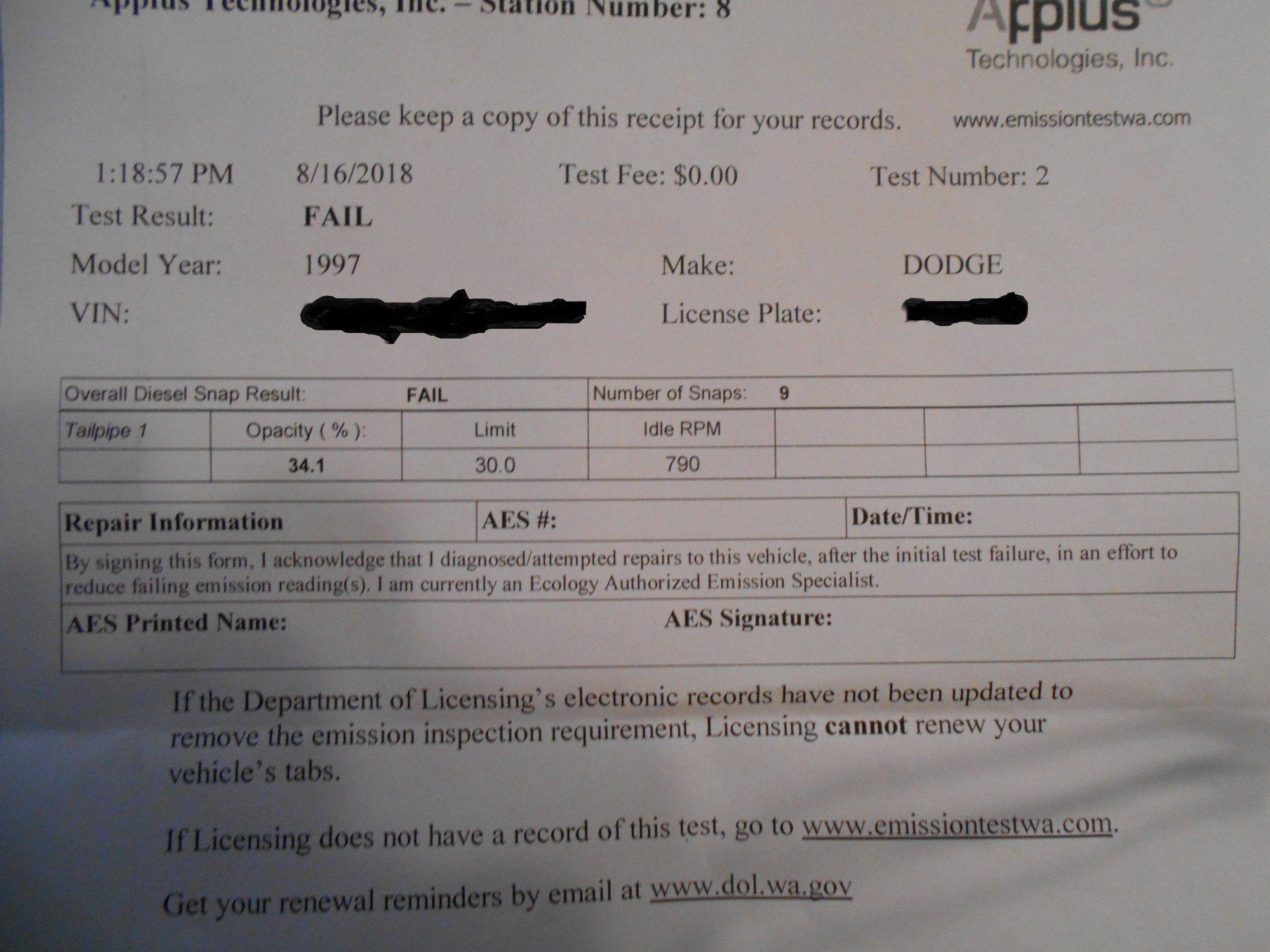

Yes this is a state run program. I have to stay in my county. I have attached the read out.
Wow NINE (!) snaps. And they did not give you a reciept of the actual test, only a bill showing some information. This also looks like a state run contracted business.
In some states, like New Jersey, you have a choice of going to the state facility for free, or having a certified shop do it for a fee. Do you have a similar choice?

In are state you pay $15 dollars ,and if you fail, the second test is free. I'LL have to see if WA lets you go to a certified shop. I talk to the mechanic at are shop,and he said was it up to temp. I did notice it was up and down on the gauge, 190 down to 150 and back up.so I think I'll change the thermostat to a 190. whats a go brand cummins , gates ,napa ,etc.
I’m still calling foul on that meter. If you don’t visibly see smoke on a snap, no way you’re 40%. A warmer engine might help. I put a Mopar stat in mine, it was a moto rad brand in a Mopar bag.
