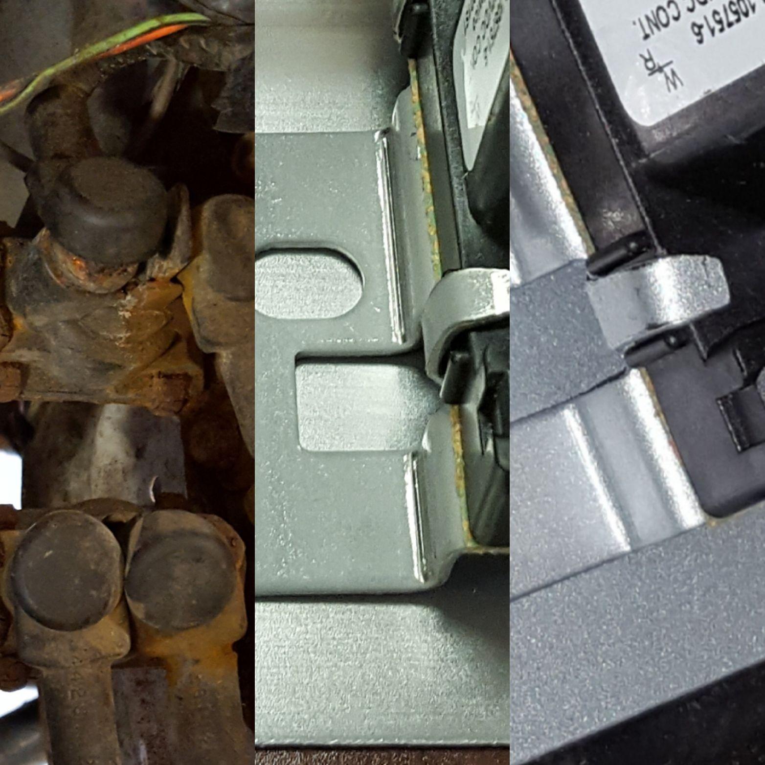

I got some grid heater relays in and thought the same thing they looked like just mild steel, knowing I did not want the same results as factory, I used GalvaBrite on the relay brackets I needed a new mount, also used it on that. I get it from McMaster, its a great galvanizing spary that has a nice metallic finish opposed to normal galvanizing spray for welding that has a flat finish. It can take minor scratches and the sort and not rust.
I had to dissemble the relays to get the mounts off, but the tabs just bend on those. Not sure on the genos plug could do the same and just spray the mount
