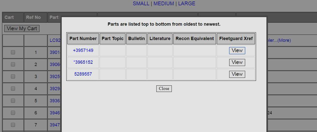

I can't get any additional information on the part if I click on it.
It does say oldest parts are on top thou, which leads me to believe that the bottom part number supersedes the one(s) above it.
