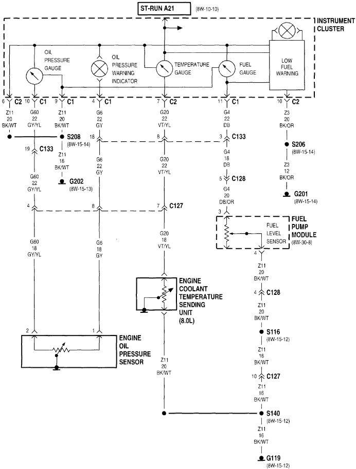

Any one know where I can get a engine wiring diagram specific to the 1997 Dodge Cummins? I have looked at Google Images and I cannot find anything specific to that truck.
My oil gauge stopped working in the dash when I replaced the power steering pump and broke the old sensor and when I replaced the sensor it still doesn't work. So, I need to find out what the circuit is doing and what wire is a ground if at all. I started tracing the wire down and found there is more than one sensor on the same circuit so I need a schematic. Any help would be appreciated.
