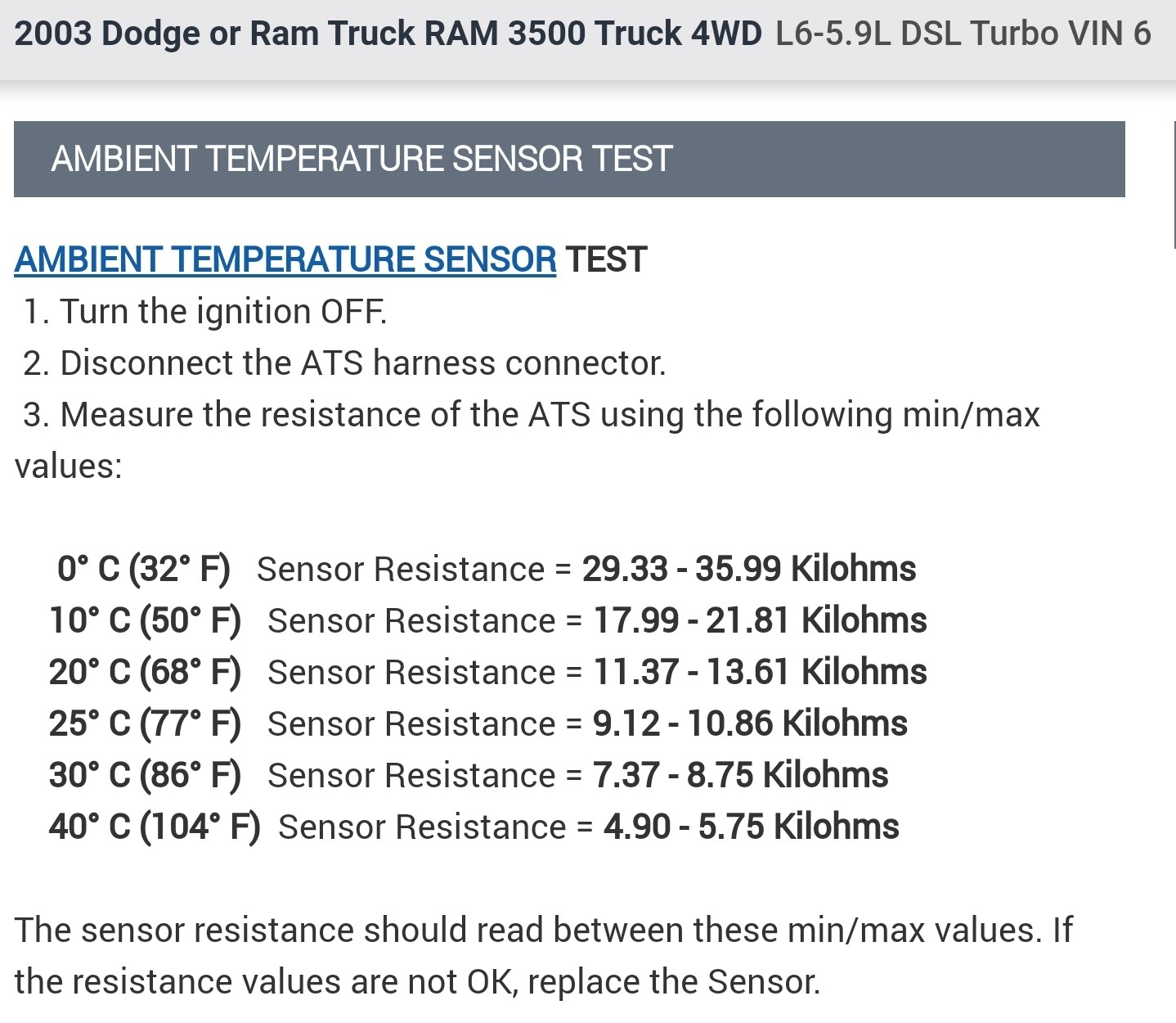

Found this:
If the CMTC/EVIC display indicates 54° C (130° F) or the ATS sense circuit is shorted to ground, the temp display will be 54° C (130° F) to indicate a SHORT circuit condition.

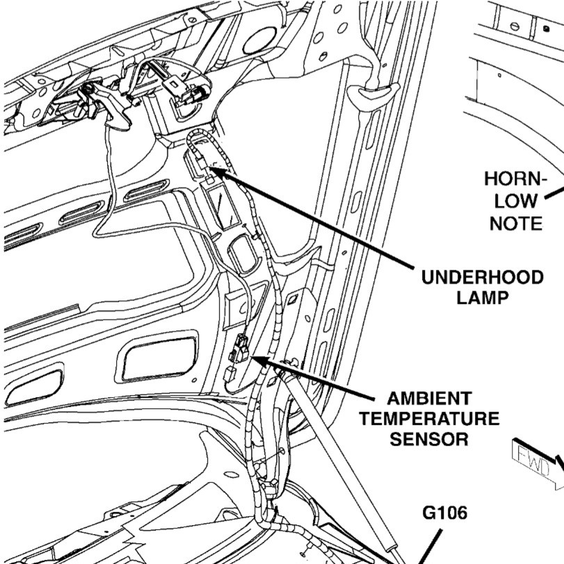

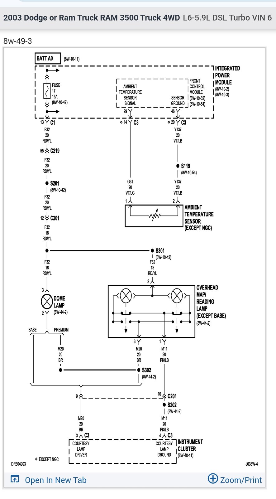

From the above -40 says the circuit is OPEN, 130 is saying the circuit is shorted.
Being the harness looks to be hooked to the hood, I would look at that harness and pinch points and bending areas.
