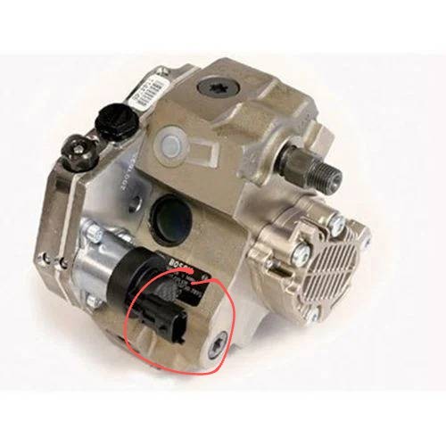

Just to be sure, can you give me an image of what I am disconnecting and am I going to need any seal or crush washers to close it back up? Explain a bit, new grounds. thanks.
Disconnect the connector within the red circle at the CP3, this is the fuel metering unit that regulates the amount of fuel going into the high pressure circuit. Disconnect is maximum fueling which it should have by default during startup cycle.
The FCA and its harness are a wear item and need replacement in some vehicles.
That is really awesome information so what you're saying is that by disconnecting that it defaults to maximum fuel pressure which was there by eliminate it as a fault or if the problem continued then we know that it's somewhere else even without having to hook a computer up to it just yet which I'm still trying to work out how I get that done I'm trying not to spend too much money right now and I can get someone out here that has a scan tool just trying to run a couple comments tests such as this before proceeding just like with troubleshooting something on an aircraft always trying the 5-minute problem before you dive deep into the 2-hour problem.
It seems like a 5-minute troubleshooting step to me thank you very much.

So since this seems to happen the longer I leave the truck parts I guess what I should do is leave the truck parked over the weekend disconnect this thing and try to start it up on my glorious Monday and see how it goes can I drive around with this thing disconnected? If I have a smarty tune on the truck should I remove the tune while doing this troubleshooting?
I know that it really shouldn't matter that much on start I guess that's more of a question that has to do with should I only be starting the truck with this thing disconnected or should I be driving the truck with this thing disconnected just to see how things go for a while?
Yes you do the right conclusion from what I've written.
And you should only start it that way and idle it. No driving.
And it will sound very rough but this is only combustion not mechanical, don't be afraid of it.

No there is no sorry for this, under load you experience the same rail pressure but then you can't hear it.
Actually it sounds very much like a 24V with the VP44.
And yes, if it starts properly you can shut it down and reconnect the plug.
You can do that under several circumstances like hot engine, cold engine, and everything in between.
