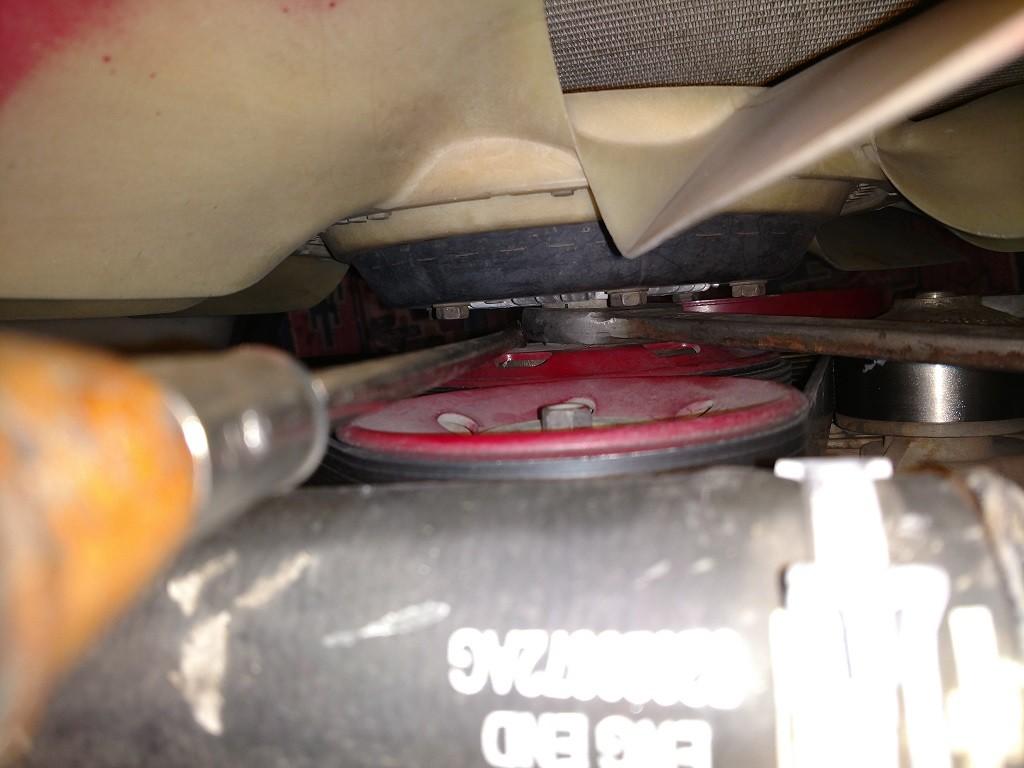

I finally got the fan clutch changed today. Based on several things I've read I got a genuine MOPAR clutch from Geno's Garage.

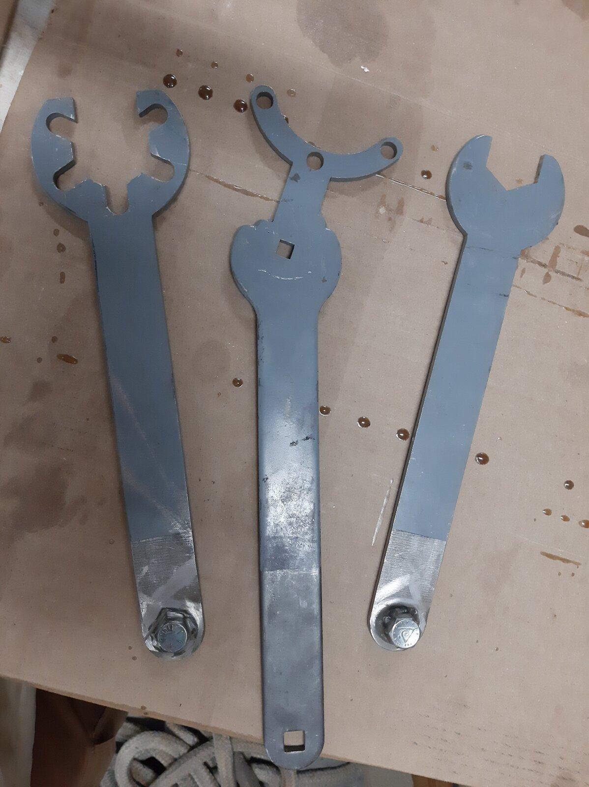

I also ordered the wrench set that's supposed to make getting the clutch unscrewed easier. The wrench set helped, but still leaves a lot to be desired. First, and most important, the handle on the wrench isn't long enough. I had to find and cut a piece of pipe to get enough leverage to loosen the nut.
The other issue is with the tool that's used to hold the pulley and prevent it from turning. It's supposed to be used with a 3/8" breaker bar or similar tool. It sits over three bolts on the pulley and it took me about twenty or thirty tries before I got it to stay in place. I also had to use a piece of pipe on it because the breaker bar flopped around too much and also wasn't long enough.
If I have to do this job again I'll weld or bolt handle extensions on both of those tools.
Once I got the fan clutch off the shaft I tried to pull it out without removing the fan shroud, but that didn't work. I removed the four nuts holding the fan shroud in place and managed to push it up with the fan inside until the fan cleared it enough to pull out. I didn't have to pull the shroud all the way out.
Everything went back together as expected and I coated the nut's threads with anti-seize before putting the new fan clutch on. Getting the threads started was a big pain, but I finally got it done.
The whole job took three and a half hours. It should have been a one hour job. Now that I know what's involved it will go a lot faster the next time.
It's hard to believe that someone designing fan clutch tools would design them the way they did. Connect a ratchet to the tool where you can't reach? a handle so short that you cannot get any leverage? I suffered the same fate, so I modified mine. They are now very effective tools and easy to use. Note the added 19 mm / 3/4" bolt heads I welded on for easy extension for more leverage
- John
I tried the "whack" method and all I did was make it mad. An air hammer on the wrench didn't work either, although it did dimple the end of the wrench. It wasn't until I stuck some pipes on the wrenches that I got enough leverage to break the nut loose.
John, I don't think I'll modify my wrenches the same way you did. I'm thinking that I'll get some steel and bolt handle extensions onto the wrenches. That would allow me to shorten the wrenches to fit them into a toolbox. With luck it will be a long time before I need to do this again. I hope I haven't forgotten how by then.
