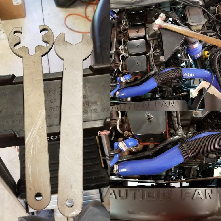

https://www.genosgarage.com/product/WRENCHSET1/tools
$36

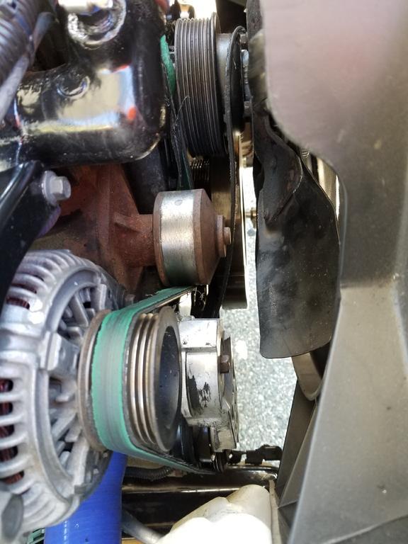

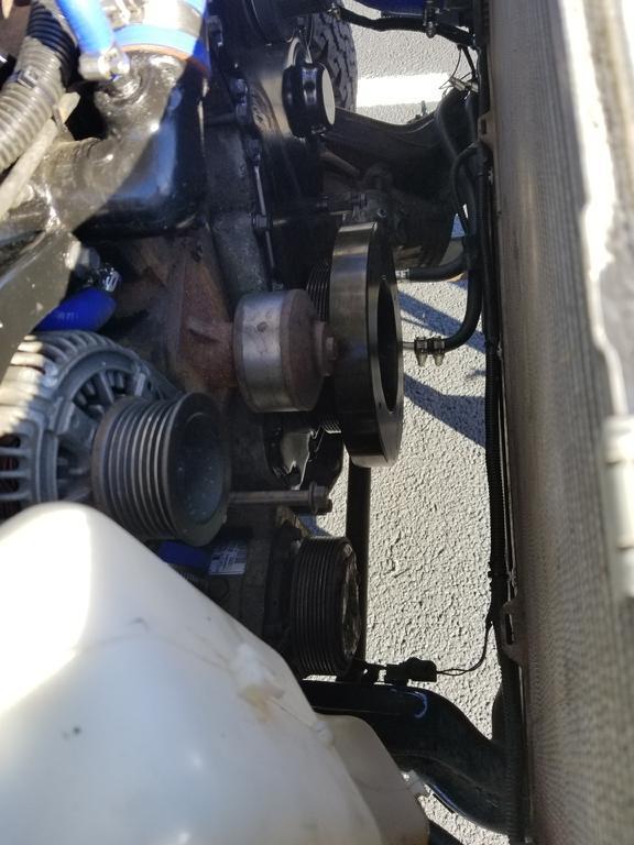

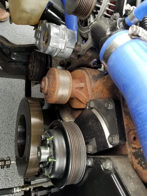

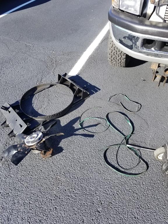

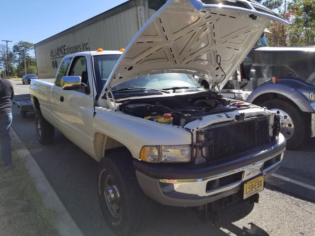

10 min job.

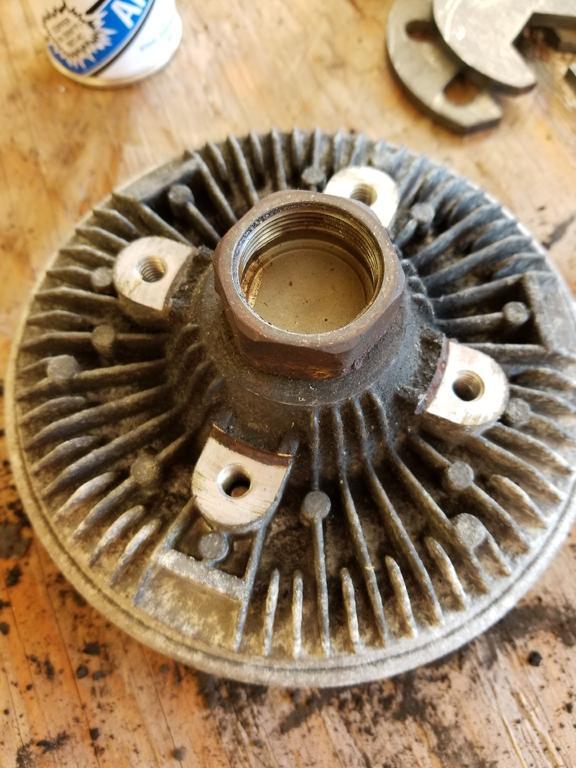

Left hand thread on nut.
Always nice having the right stuff to get it done quickly.
Old one was seeming to seep a bit, throwing some oil on underside of hood.
Geno's had the clutch as well, no issues installing.
