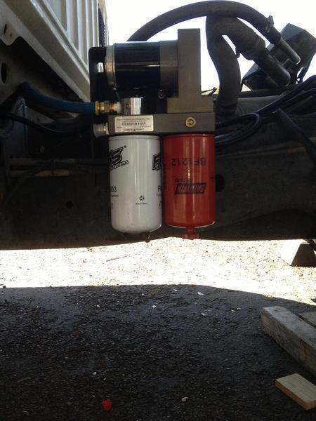

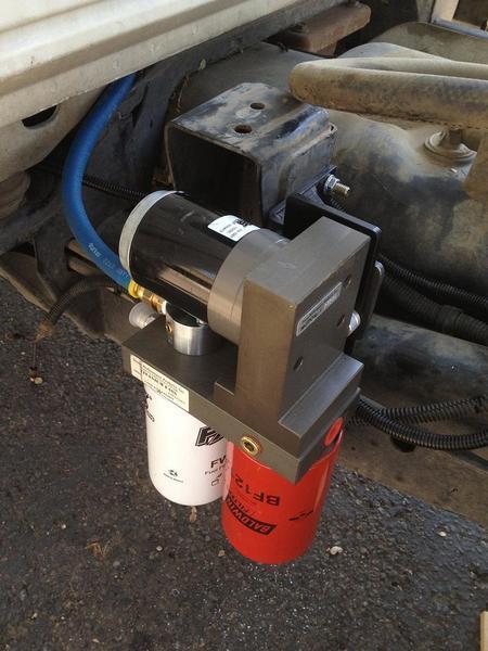

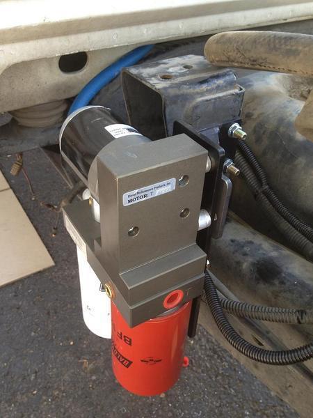

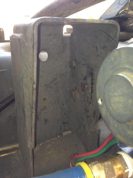

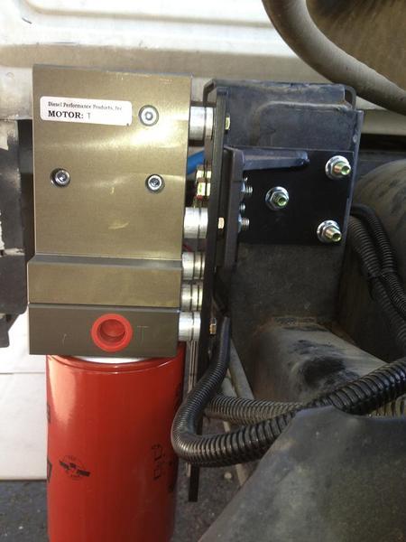

I'm sure there's already enough pics of a FASS pump mounted to the frame but here's some more anyway. I have the bed removed because I've had a fuel gauge dilemma that kept giving me false readings so I suspected I was going to need access to the fuel module anyways.
My OE engine mounted pump died miles ago so I already have the in tank module/pump. However, I don't like the draw straw pickup tubes that come with most FASS/ Airdog kits and I certainly didn't want to drill any holes in my tank so I bought one of these http://www.vulcanperformance.com/ProductDetails.asp?ProductCode=FMDS to keep the fuel flow operation somewhat stock.
I'm also fabbing a quick release filter guard from 3/8" plate that will cover the front of the first filter and shield the bottom of both filters from road hazards. Will post pics in this thread when that's finished.
