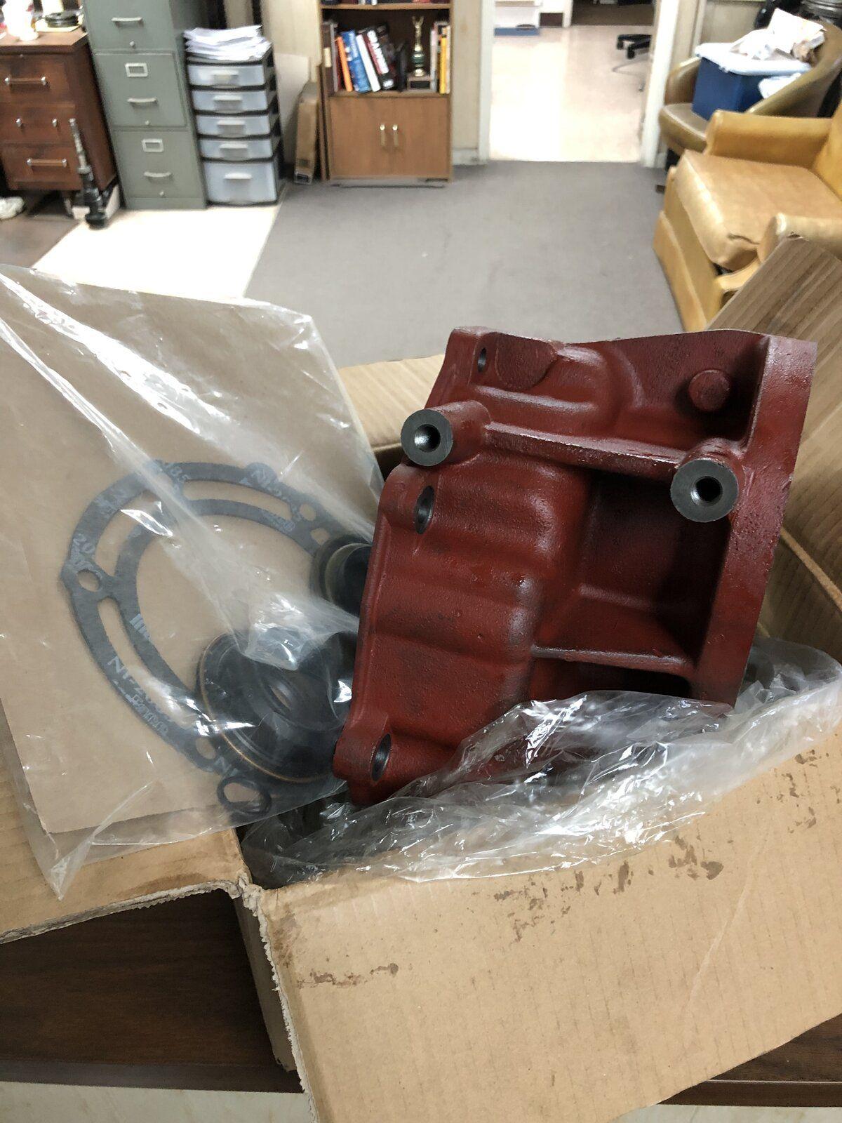

Well, I’m 7 hours from home and mid-vacation.
Got a cracked transmission adapter housing. :(
Sourced the parts yesterday, have a borrowed garage to work in, so hopefully by tomorrow we’ll be motoring on toward Big Pine.
Have been reading half the night horror stories about poor quality of these aftermarket cast iron housings, but those threads were from 2005, hope all that is in the past. Got the housing from a rebuilder that was recommended by another 2g enthusiast who has one on his truck, so I feel good about it.

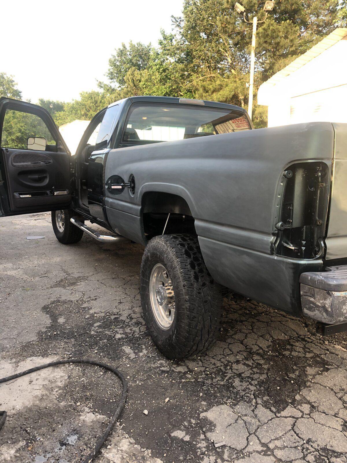

Still haven’t installed the throttle recall parts, but did get the bed repainted, and also the topper.
