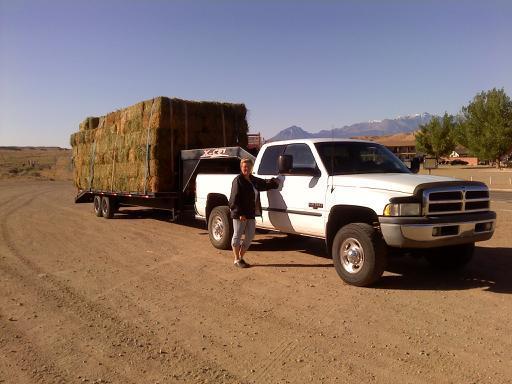

To the OP. I see no reason you can't start with a 2500. An '03 2500 is basically the same as an '03 3500 SRW. I tow with 2500's. Flatbeds can be a lot of work. Such as hauling hay, most is hand loaded. Backing up to a ready made, new RV is tempting. No cost to buy and always a new unit. Or like Greg, he hauls new Gatormade trailers, all stacked by the factory, not much labor and no trailer expense.

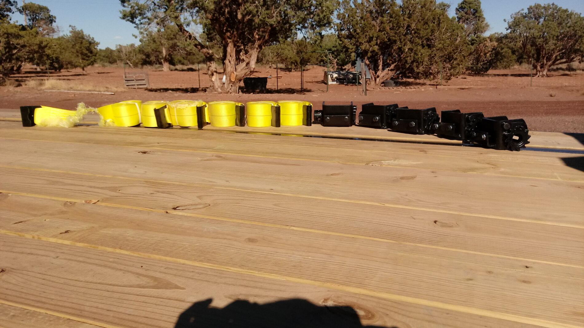

Just some of my tie downs. I also carry (4) chains and binders and (4) 2" x 27' ratchet straps and (4) 2" x 12' ratchet straps. A 12 volt winch is nice. These are 4" x 30' with portable 4" winches.

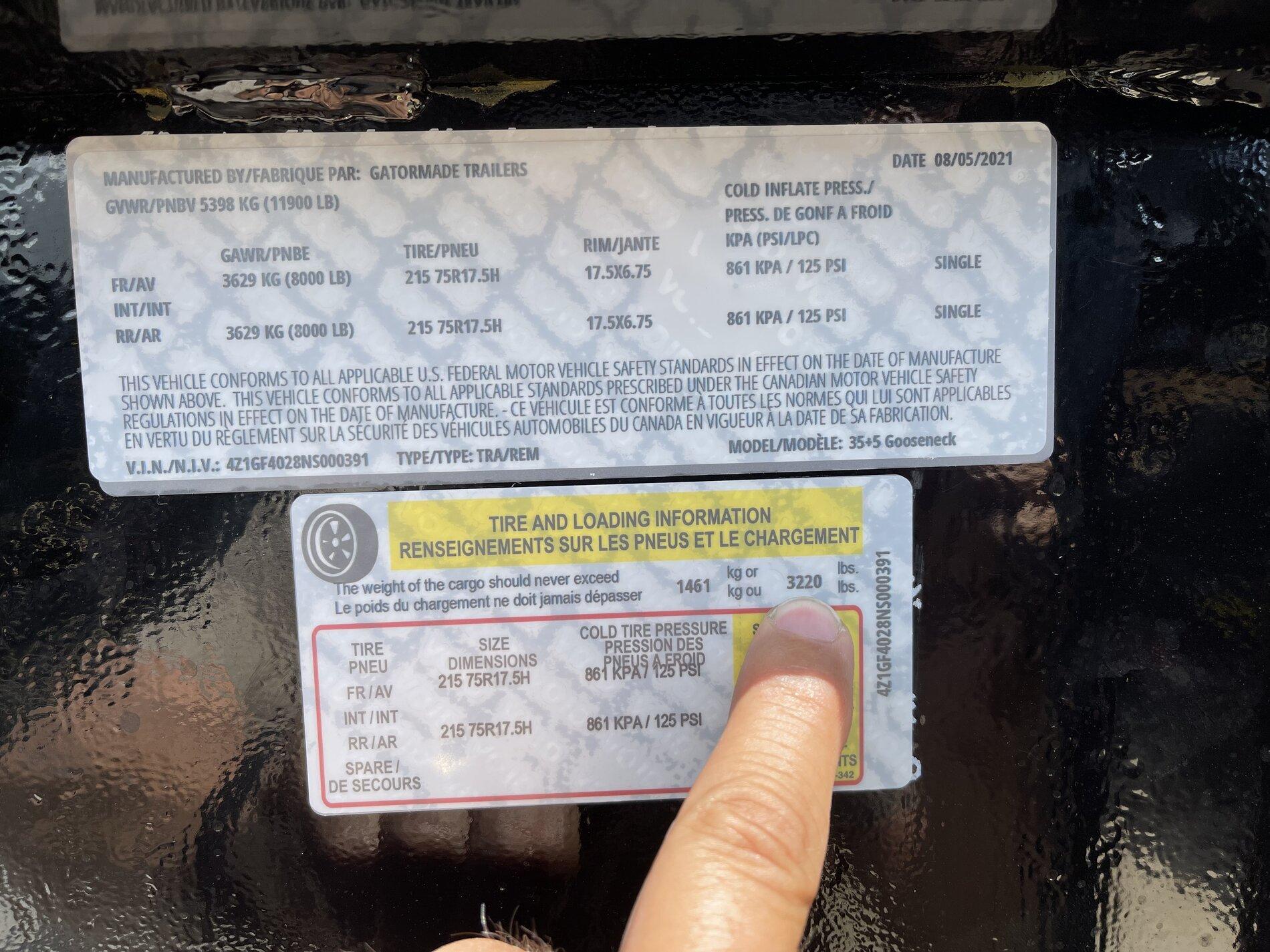

If you want to see something comical.....look at this de-rated 35+5 with 8k axles and 17.5’s. Was de-rated to 12k....so it could be pulled by a 14k dually pickup....trailer weighs in at 8,780 lbs.....cargo capacity is a whopping 3,220 lbs.
My point exactly. What is the point of dragging around 40 ft of trailer if you can't carry any real weight?
