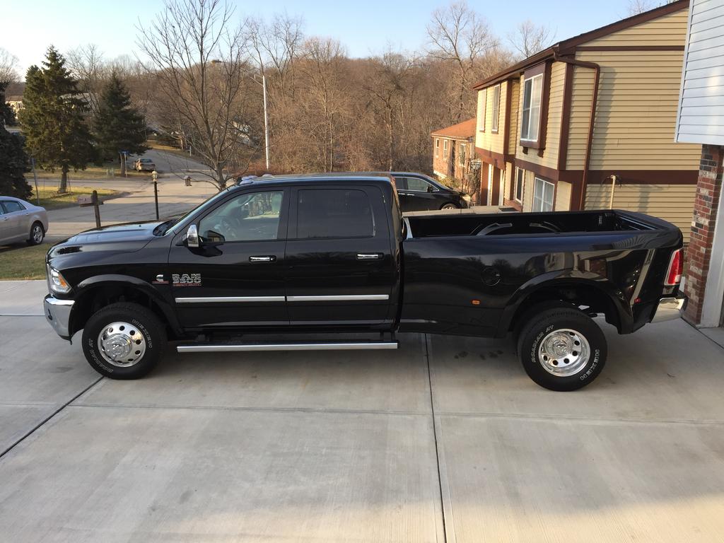

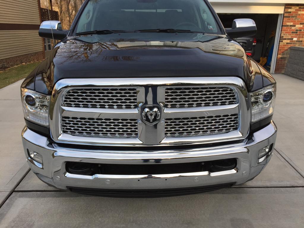

Not new to trucks. But, admittedly have A LOT of firsts going on here and coming from an '06 gasser XL reg cab superduty, I'm pretty damn excited about the list!
Over the last couple months of fighting with dealers over purchase price and trade in value (I'd call it negotiating, but that term doesn't cover it), researching, and looking at trucks I quickly came to realize that I was no longer buying a new truck, I was buying a small RIG. I guess when you start measuring your driveway to see if it's all going to fit (truck, trailer, other vehicles) that should tell you something. I was looking for a 6.7 crew cab dually with Aisin and 3.73. In the end, it was a toss up between a white Tradesman and a black Laramie from the same dealership. The Tradesman had everything I needed and way more than what I already had comfort-wise in the xl trimmed superduty. I was shopping FOR a Tradesman! Should have NEVER got into that Laramie...LOL
I'll get on the signature soon, but you already figured out what I ended up with. 2016 Laramie 6.7 CTD, Aisin, 3.73 4x4 Crew LB Dually - WOW stoked is an understatement Oo.

Nice looking truck. Can't help you on the turbo lag. I've got a 2015 SRW and have never experienced it. I do a lot of towing and it has never stumbled or lagged in over 17,000 miles. It will break the tires loose if I hammer it too hard. I have the 68RFE so maybe that's the difference.

Congrats on the truck.

Congrats on your purchase, nice looking truck. Haven't experienced any hesitation on my 2015 3500 SRW, over 11,000 miles on it so far. Tows the 5TH wheel with ease. Getting an extended warranty with all the electronics in these things I feel is good insurance. Enjoy.
