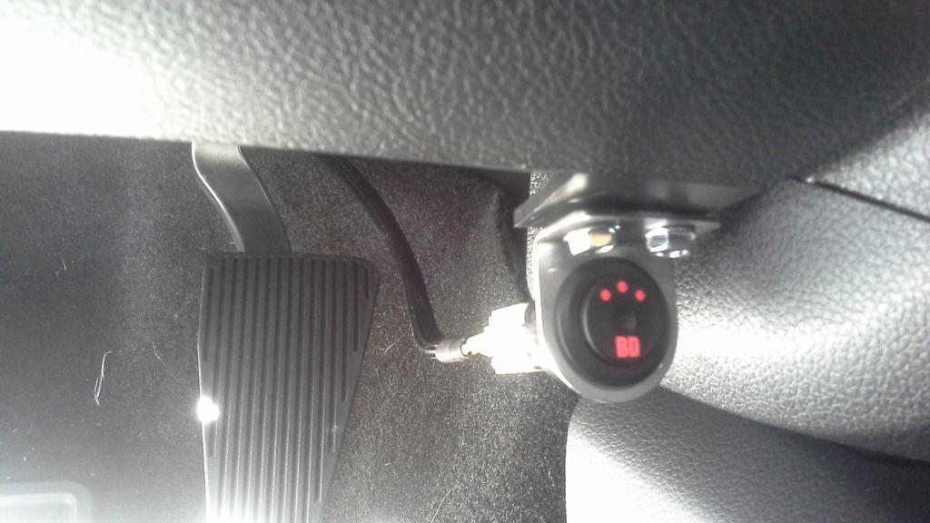

My BD Throttle Sensitivity Booster has helped the turbo spool quicker. On 400% boost, it acts like a lamborghini.
But I don't use full (400%) boost unless I need to accelerate onto a freeway up a steep grade. Under stock throttle parameters, the truck has trouble accelerating its own weight from 20mph-50 mph because at these slower speeds the torque management inhibits acceleration.
Above 50 mph, the truck accelerates very quick even at stock throttle settings. No perceptible lag/torque management/dead pedal even at stock settings.
Some of the city ramps have tighter curves and require 30 mph cornering. Then when you hit the uphill part, torque management is a real drag.
