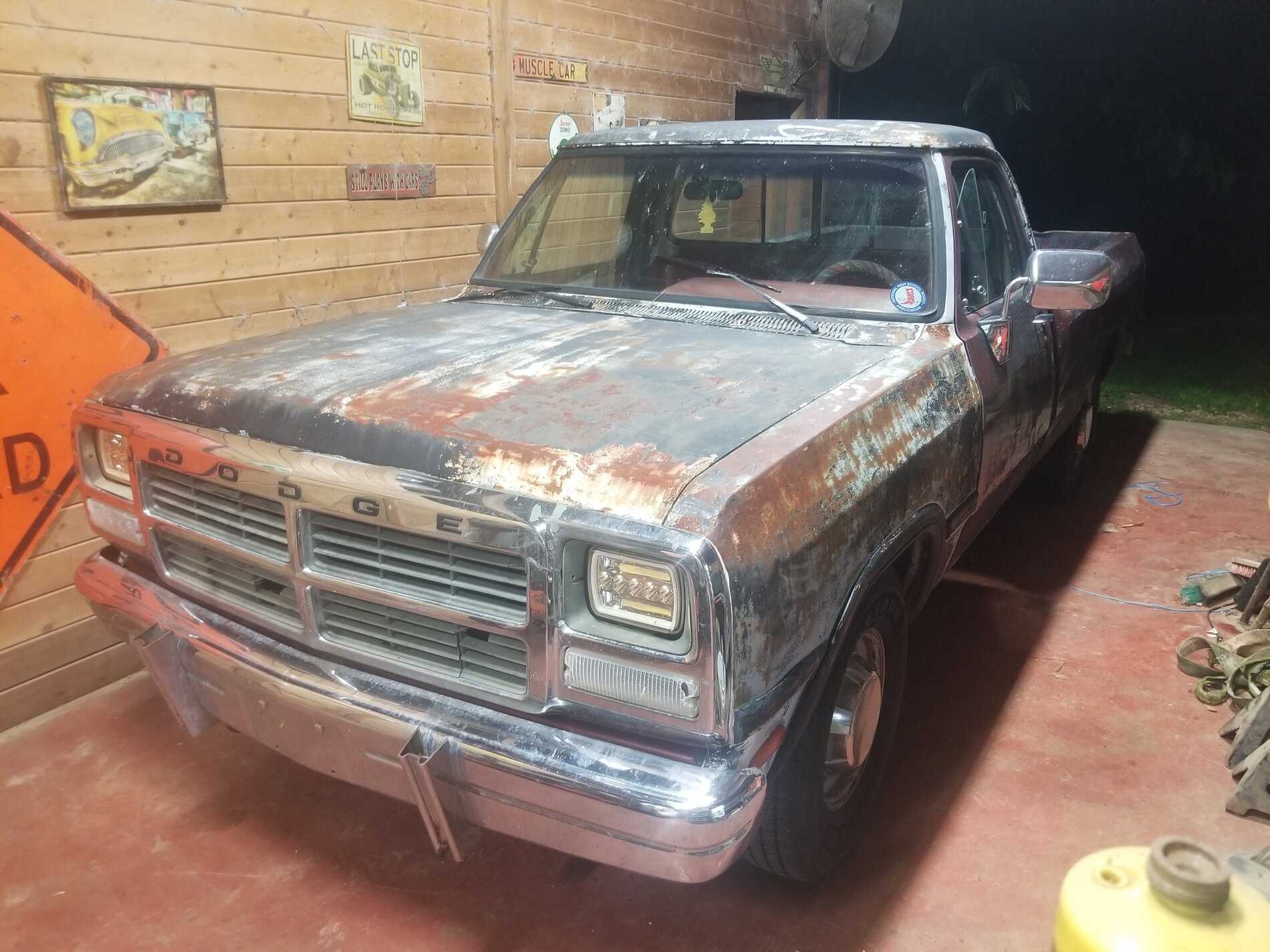

Thanks for the responses , door sticker says front suspension rated at 3830# ... see references online elsewhere to 4000# axles and haven't had a chance to check yet due to having to go out of town for work but apparently HD suspensions have 7/8" dia. tie rod ends which I guess would be easy for me to check but I am fairly certain I will get the heavy duty ball joints which are press in . GSP7 here is your picture ...she ain't pretty but runs like a sewing machine . It needs a Borgeson steering shaft , a spare tire ( came with new firestones on it) , some air conditioner crush washers so I can recharge system, odometr works but not speedo and maintenance to fluids and such ( changed oil so far but that's it ) pretty sure the original color was white but previous owner thought it would be a good idea to slather bedliner over the whole truck ... fortunately it was ****ty bedliner and it is flaking off ... unfortunately they tried sanding the front clip and that surface rust there is the only rust on the entire truck (ok, the battery tray is rusty) the undersides are immaculate , the truck has 194000 miles on it and I paid 3500 bucks for it. View attachment 138714
