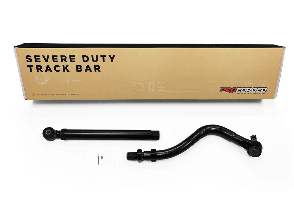

Here is another option and I think it is a good one. It is called Proforged. It is OEM style track bar with a very heavy duty ball stud and quality weather seal. The bonus is that it is adjustable in length after it is installed. It is definitely heavy duty. Many places to purchase and right now it is on sale for less than $170.00.
https://www.supershops.com/products...mponents/track_bar_components/parts/106-10109
Only 20,000 mile on mine so far, but I think it is going to last a long time.
- John

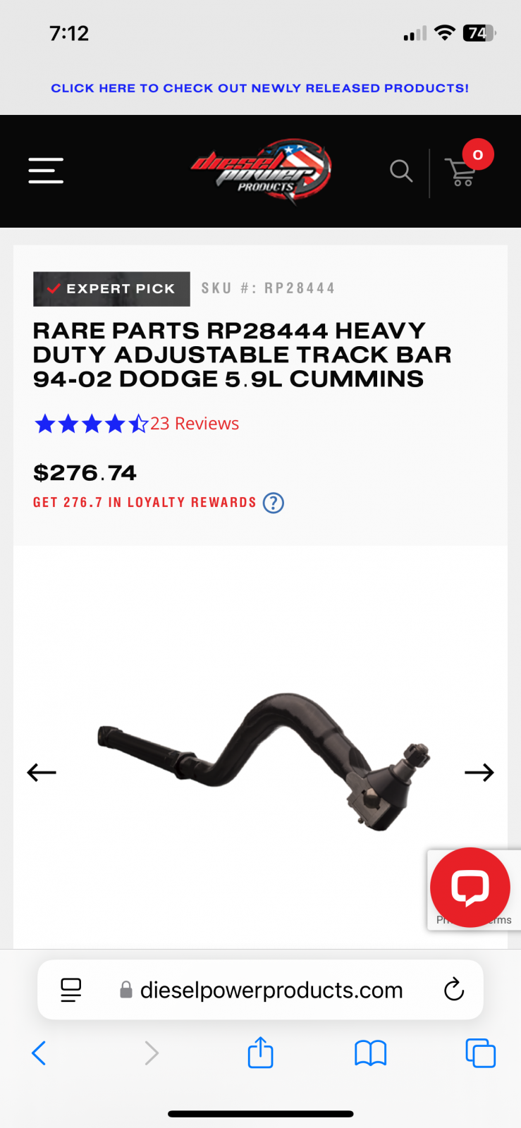

I installed this on my 01 Sport 2500 at least 50k ago. Still nice and tight.
I installed the early version of the Rareparts track bar in 2016. It lasted for 115,000 miles. The early version was length adjustable, but only when one end was disconnected. It also had a poor quality sealing area on the ball joint end and I knew that this would ultimately shorten its useful life.
It looks like the newer version has addressed both of these issues, so I would expect the newer version to last longer.
- John
