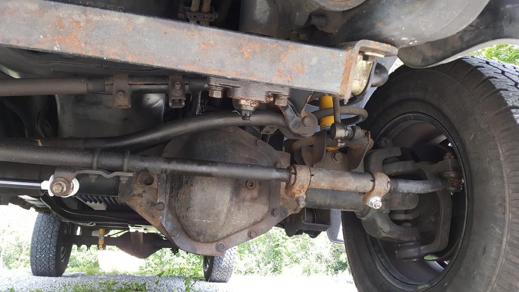

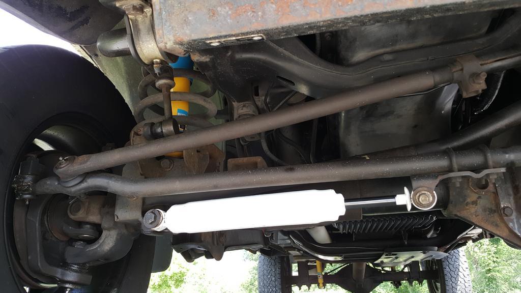

Ok so I contacted cjcoffroad and they said I could use the Carli low mount steering stabilizer on my truck. Weird thing is it says for factory 08+ T-style steering. As far as I know I've got the Y style, but, if I look at comparison pictures I get confused of the Y and T. See attached pictures for a better visual. Truck has had a 3rd gen track bar conversion (before I got this truck).

Was this standard or upgrade with 3rd gen track bar upgrade do you know?...
It has nothing to do with the track bar. There was a HD steering option available in '99 and maybe 2000 (unsure of the years) that was the T-style. It was a popular conversion when the Y style wore out. I did it on my 97 many years ago using off the shelf parts.
Interesting...possible is came on the 98 stock?...previous owner did any and all upgrades on this truck and doesn't recall doing a Y to T.
Yes it did. 99 and earlier had the preferred (T style) steering set up of the 2nd gens. In 2000 they changed the front axle from the balljoints out as well as the steering set up. A short explanation of why imo T style is desirable is toe in does not change with loading as you go from running empty to max gvw and everything in between. Load distribution among components is better equalized across the board on t style. It seems to be the better set up for a HD truck, at least of this vintage.
Good clarification on this.... thanks
My 97 had the Y type originally. The T style was a "heavy duty steering" option in the later model 2nd gens. It may be possible it was stock on the OP's 98, I'm just not sure what years it was available but T style definitely was not standard on the early 2nd gens.
You could be very well right. I just know it was available factory on the 98-99 (Bills year truck). Point being the drag link attaches to the tie rod in a position that is very close to the knuckle. The idea is that the less distance between the drag link and knuckle, the firmer the steering will be.
Starting in 2000 they changed up the axles from bj out including steering linkages. The tapers are all smaller making components non interchangeable. So I assumed it was all early 2nd gen...but we know what happens when one ASSumes :-laf
