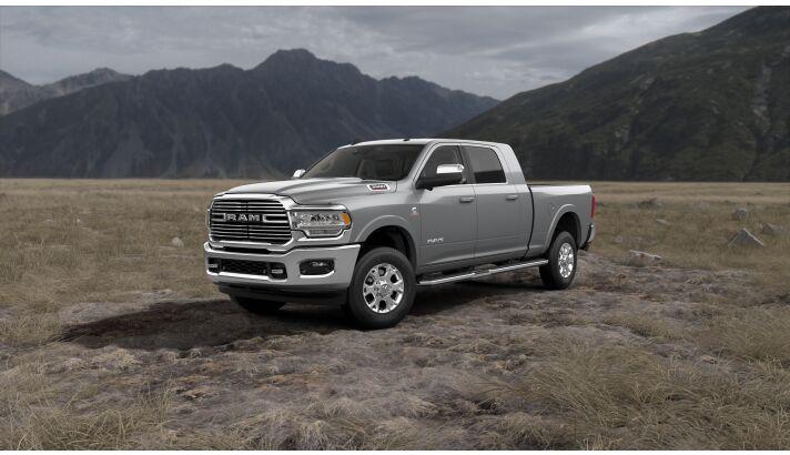

The below picture is a SRW 3500 with the Aisin and 1000 ft pds of torque and 410 gears.
Good catch on the tire size! 18's are definitely the way to go. Not only for ride comfort but cost and availability of sizes and brands down the road when purchasing new shoes. And if going SRW 3.73 is now the only available gear ratio which is good for your prescribed tow #'s.
I'd also do the air ride if I had the choice. That is not your issue of a harsh ride.
