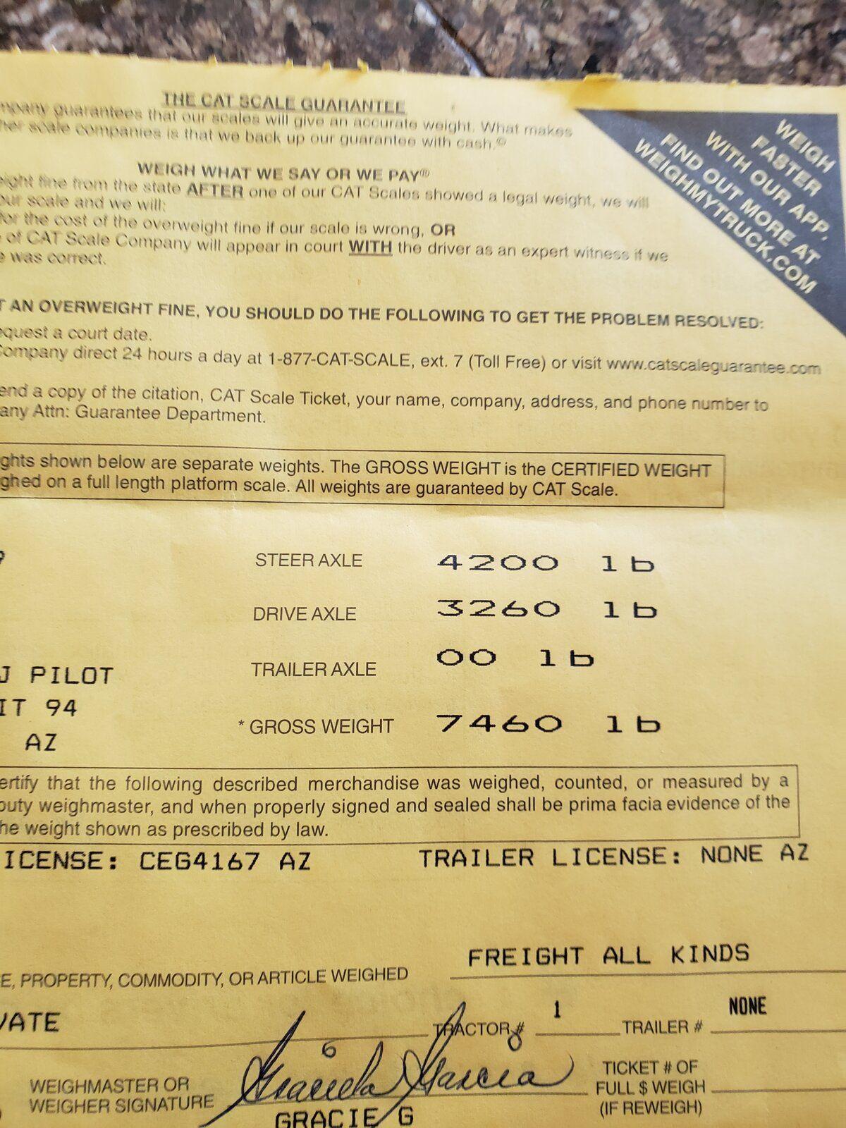

You tell me, FULL RAWR in pic of 9,750#, truck sets exactly the same unloaded.

My 2500 gasser weighed @7400 with a full tank and me in it with normal "stuff" that accumulates, and that was a Tradesman. Around 3300 on the rear axle.
