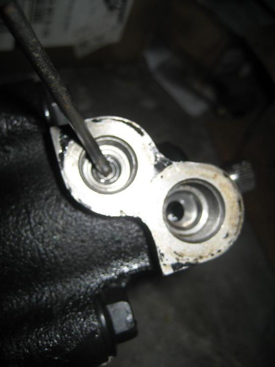

I finally got frustrated enough with the lack of assist with new, better?, bigger steering gear from Mopar. I pulled it and put the Redhead back in. The Redhead is so much easier to turn.
I examined the 70214AA box and noticed at the port for the incoming high pressure line, there is what appears to be an anti-backflow device (a metal cap with a spring behind it). If I push down on it with a screwdriver, it goes down maybe a little more than 1/16". Now, I will be the first to admit I am not a hydraulic engineer but it seems that is not enough flow when gpm is important.
When the 70214AA gear was in the truck recently, I tested the pressure and it came back to 200 PSI at idle between the pump and the gearbox on the high pressure side. According to old specs, they say if idle pressure is over 125 PSI, check for restrictions.
For those that have access to the new upgraded gear, can you check and see how far that anti-backflow cap drops down when you push down on it?
I would like to remove it but I am not sure how involved of a process that would be. I would prefer not to drill it out and leave metal chips in there.

I went to the dealer with the old box and compared it to a new one. The new one's check valve? plunges down a little more than mine did, possibly letting more flow through. I exchanged mine for the new one, even though it was slightly past the 1 year warranty.
I am still toying with the idea of removing that check valve before installing it. The old boxes I have seen did not have one.
I verified with a couple of sources that the item is a check valve, designed to limit steering wheel kickback if you hit a rock or a curb. I bit the bullet and carefully extracted the check valve pieces from the outside. I used a screwdriver and needle nose pliers and was careful not to leave pieces of metal in there.
I was going to take a photo of the finished product but I could not find the camera. I put it back together and it is an improvement from before. The steering wheel returns almost all the way to center after a turn without being "notchy". It is still a little tight but it is a new box. Overall, more enjoyable to drive. Less effort required to turn right/left and that issue was really bugging me.
