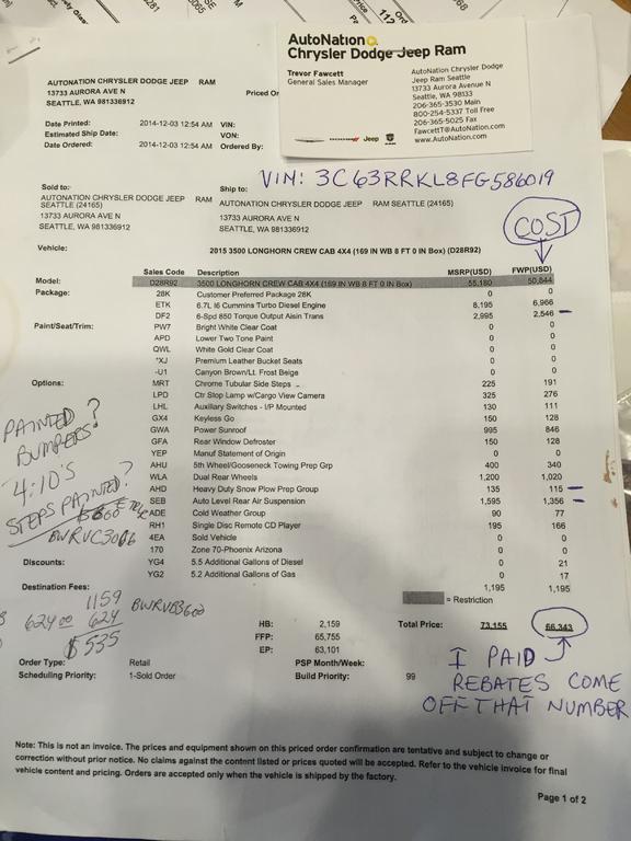

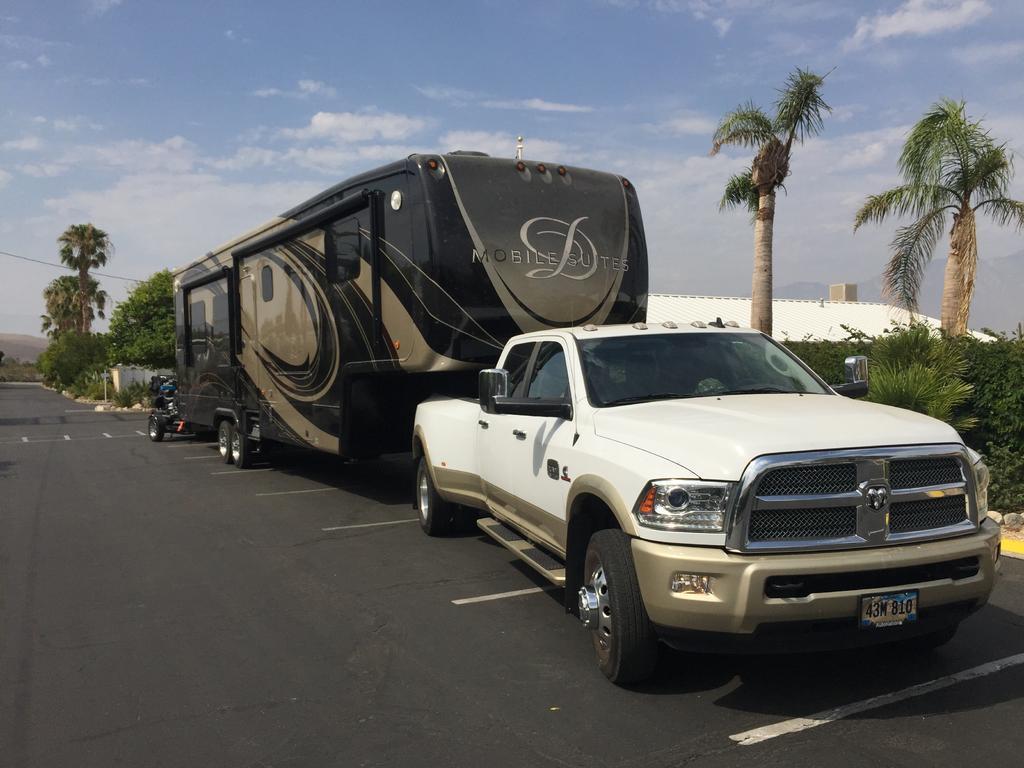

Joe and I have emailed about this subject for a while. I sent this email to him 8/2/17. I understand he is having a hard time getting specific answers.
Hi Joe,
I will send you several emails with pics. One shows how HD the brakes and front suspension are on the 13 and up Dually’s. Also shows the factory Rear air ride that I HIGHLY recommend, well worth the $1,300. It keeps the truck at a nice slightly high rear ride empty of fully loaded to 9,750# RAWR. It makes the truck easier to get in and out since it rides lower than the non air ride trucks and also has a better loaded and unloaded ride.
Laramie is a nice trim level with leather available. I will say it’s nice but if you set in a Limited or LongHorn it will be hard to buy a Laramie. I know this from experience! The interior pics are from LongHorns, the Limited is basically the same but in a more black scheme. Still same high end finish and high quality leather. IMHO I do not like the look of the new Limited grill. I really like my LongHorn I can tow a 10 hour day and feel fine other then a bit tired the seats are so comfortable.
I would highly recommend the 4.10’s, at 60 the RPM’s are about 1,750. The Exhaust brake is VERY good. I towed several miles of 14% downhill last summer locked in 2nd holding 30-35mph a nice speed for the grade even with the curving road.
The AISIN can’t be beat it is a True Medium Duty Trans as it is used by several others in MD applications. They are basically bullet proof. The Cummins is a True MD engine as it is used in many other MD applications. The Bosch CP3 injection pump is another very dependable item. GM had enough of the CP4 pump same as Ford uses and went with a Denso pump for 2017. Lot’s of warranty claims. This is a biggie to me if going past the 100K warranty.
Ford IMHO makes a very nice truck and would for sure consider if buying a GASSER. But the new 6.7 has had some issues with injection pumps and other items but they have corrected many of the issues. To me the engine is too complicated past warranty as in big cost to repair.
GM would be my second choice if the RAM/Cummins was not available. Something interest is GM limits its towing to 23K, I am guessing with the new power the trans is only able to meet the SAE spec. I have read many times the Allison is in need of a big update. It is not as robust as the 3000 that is used in MD applications. The Ford trans has proven be be very reliable.
The Cummins delivers it’s power at lower RPM’s and does not “feel” as fast or like it’s pulling as hard but it is.
I don’t know where you travel most but I am usually West Coast and my 33-35K combined load is no struggle. Oh another thing the temps stay nice and low on the trans and engine no matter the outside temp or grades.
I would call and talk to Dennis Dillon and Dave Smith both in Idaho, DS sells GM’s also.
I am happy to answer anything else so let me know.
Ron
"Looking at the posts on the tow mirrors--that tow mirror situation might be enough to keep me in a Ford....sure look awkward to me."
NOT awkward at all! I really like the mirrors. IMHO not much of a reason to sway your decision. Come over to NW WA and I will let you drive my truck and even hook to your RV for a test run.
Order this and you will be more than happy!
