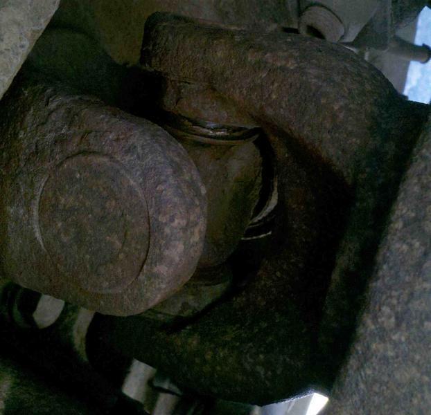

I could make a poster out of that photo to remind me never to leave the desert southwest, lol.
Ah, so you "missed" the whole sheet metal, pop rivets, tar, unistrut thing that my dad taught me to keep vehicles "intact". ;)
Can you tell that I grew up in upstate NY between Buffalo and Rochester, the land of rust?
I used to periodically spray sealant under the '91. So Yo Hoot I am in full agreement that it's indeed a smart thing to do. But somehow twenty years later I don't seem to get as excited about rolling around on the ground under a vehicle. Need to get a lift!
