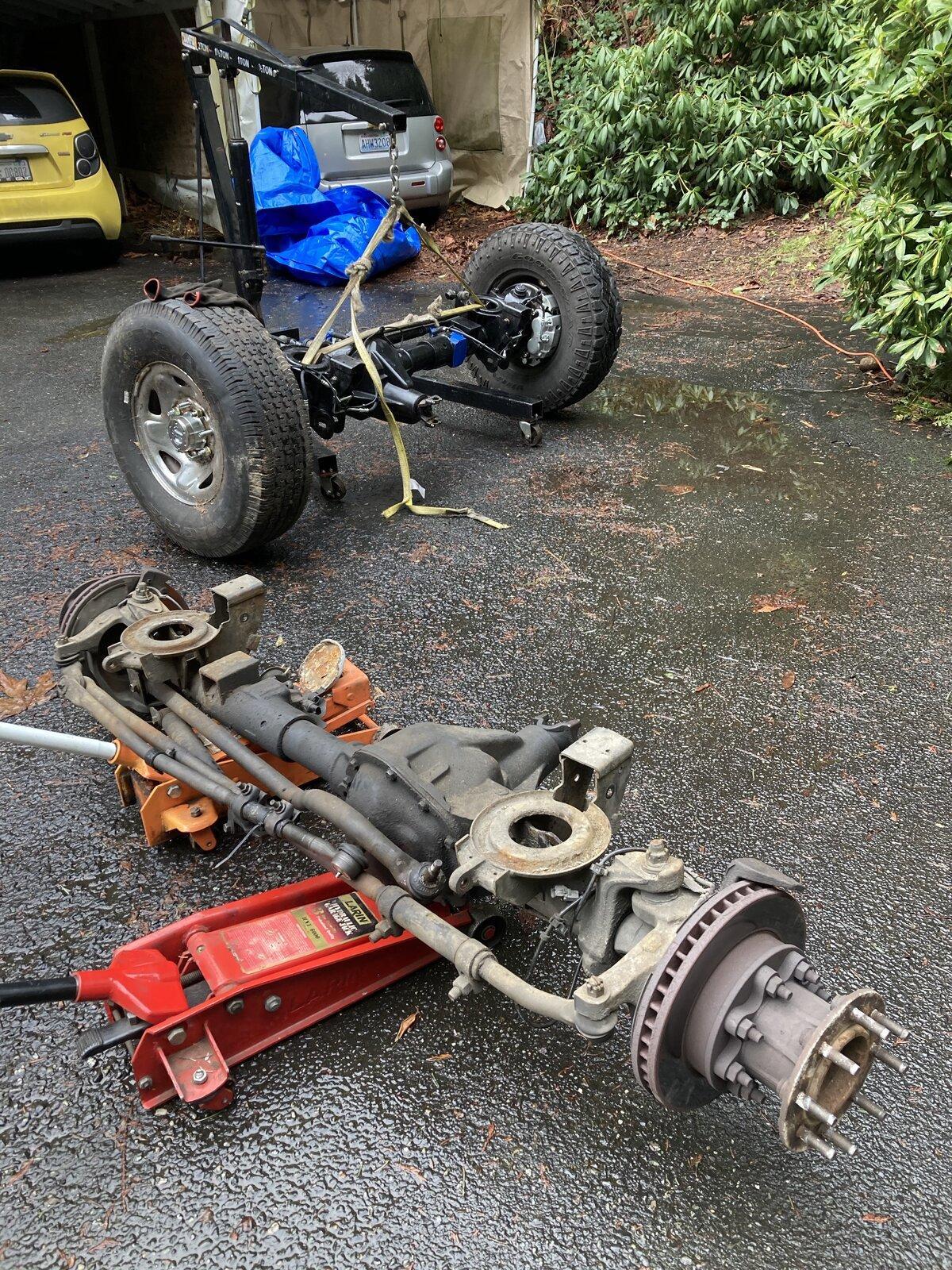

Can a front axle from a single wheel truck be swapped in to replace the axle of a dual rear wheel truck ?
So I can just bolt the extensions on the single front axleView attachment 128953 The only difference between the DRW axle and SRW dana 60 front axles is the hub extensions. The axle shafts are the same. Be careful on what year axles you get. They had a major change in 2000 from the early models. If you are thinking about changing the whole axle housing it isn't very hard. While your at it you could upgrade the axle to a 2000+ assy. You will have better brakes, bigger axle shafts, larger axle housing. Been there done it.
