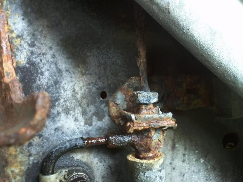

Attached is a picture of the leaking line (broken), You can see why I was not thinking about getting some replacement lines and bending them myself as the section is totally done.
I'd say shes a little over due! Last winter I had my front end torn down to do the ball joints and while I was at it I replaced the brake hoses (which includes the fitting in the picture) and the hard jumper line that runs from the driverside. I can understand about not wanting to work outside, I've had to do that myself in the past. Those prefabbed lines are pricey! I bet you could buy a roll of the copper nickel and some fittings and pay someone to do it for around the price of buying all those prefabbed lines and doing it yourself...

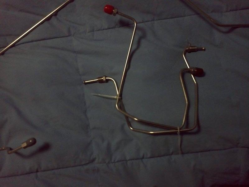

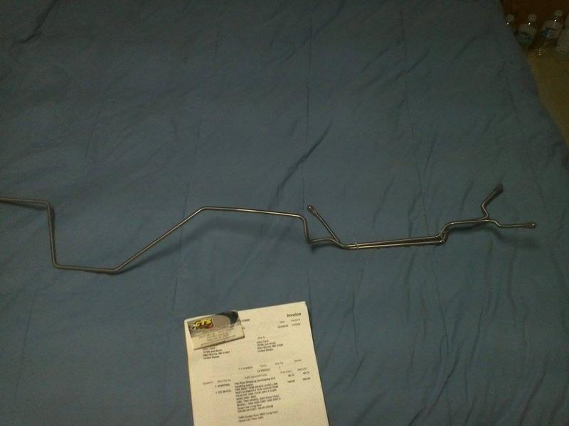

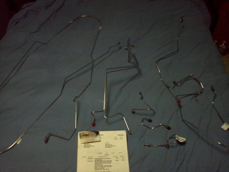

So just to give you the route I went. I ordered the Circletrack kit. Girlfriend (wife, been together 10 years) told me to go this route and she would put in half as my birthday gift. The kit showed up last weekend and looks to be very nice and hope to find out how it installs/fits in the next couple weeks. Its been snowing/icing here and cold the last week, so have not been able to do anything outside and my friends shop it booked solid until 2 weeks from now, same story with my 2 car garage (has 2 projects cars in it right now in non rolling state) I picked up all the rubber lines from rockauto. So should be to ready to go.
Some pictures below :
Stainless Steel tubing and fittings. I wanted to get there Kevlar Braided Stainless Steel Flex Hoses also, but at $200 for a set vs $6 - $15 for the rubber lines each, rubber won out on this years budget :)

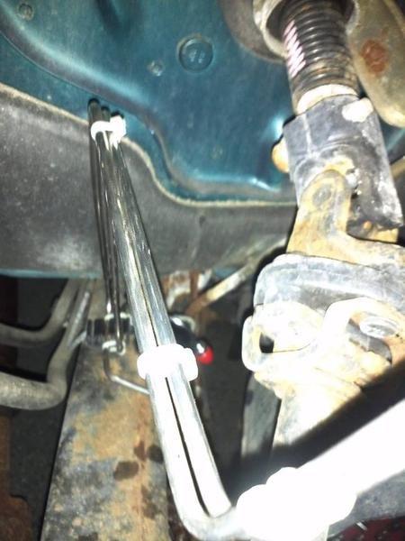

Well did the install today! 9 hours of hell! I feel like I was in a UFC fight. This kit from Circletrack (EGR brakes) is wonderful and I believe worth its $340 price tag. There is no way I could have completed all the work in 1 day.

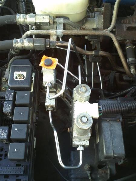

Here are some pictures :

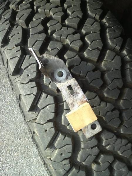

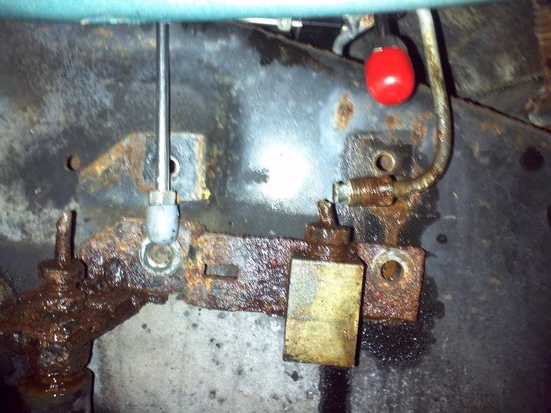

JUNCTION BLOCK before removal. It was in bad shape!
Sandblasted the JUNCTION BLOCK and give it a good coat of primer and paint. My camera died so dont have a picture of the finished paint job. :

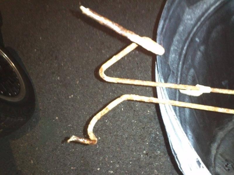

Old lines :
