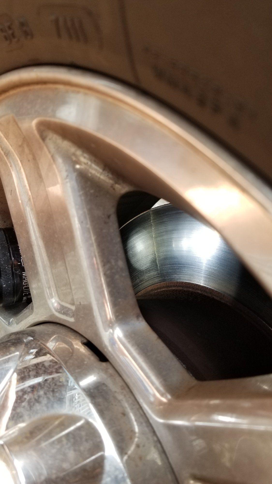

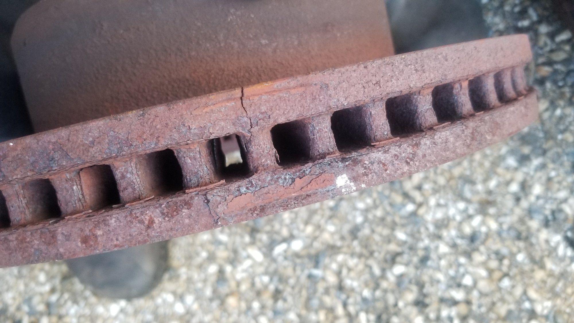

I felt a pulsation when breaking over the past couple of days. I was thinking it was a warped rotor. Well, this is what I found. Needless to say I'm in search of rotors. Should I stick with OE or is there a quality after market pad and rotor set? I read good things about the factory severe duty pads but couldn't find the part number.
The important thing here is what caused this? I do haul a 14' tandem axle dump trailer but this seams extreme for such a small load. We received a lot of rain recently, could hot breaks being quenched by water from the road cause this? Input is appreciated as I'd like to fix this once.
Here's the kicker- truck only has 64k miles on it
