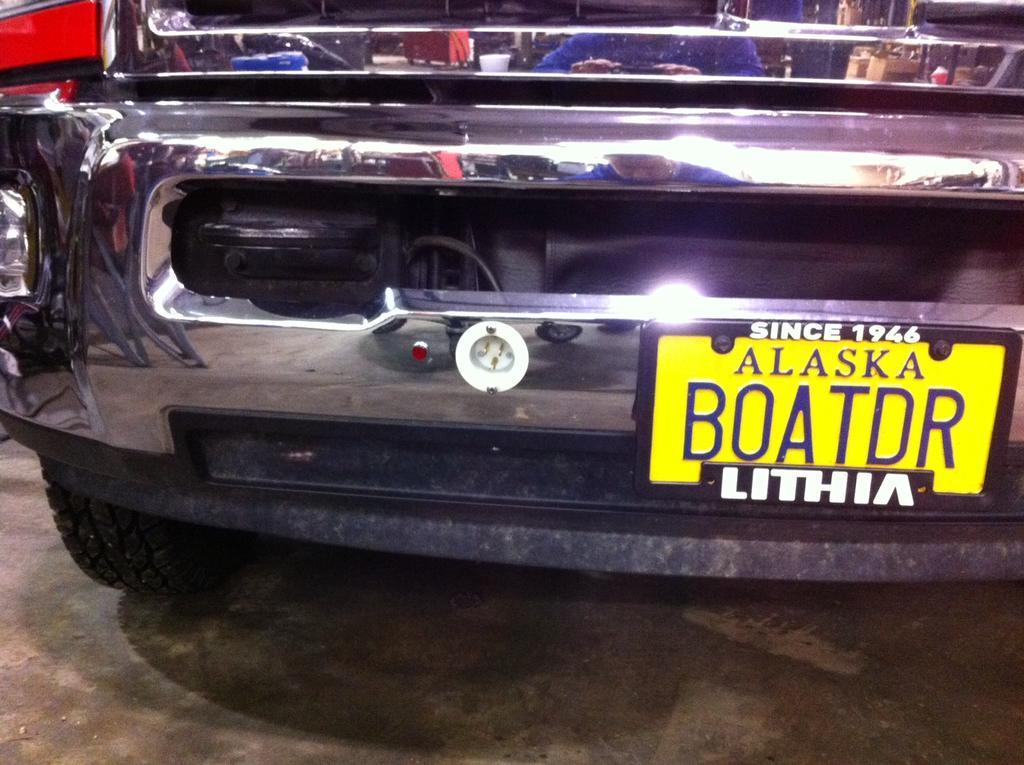

Has any one mounted some kind of covered plug like is made for the Cummins on there bumper or in the grill area ? If so ,what did you use ?
Here is what I use.......you can get a similar option with a cap if needed. I haven't found the need for a cap.
I got it from a local electrical vendor and the brand is Arrow/Hart. Part number is 5278C
The little light beside it is an NSI industries 79740LW and you can get different colors
Geno's Garage sells one for the 4th gen and 3rd gen trucks, I have the one for the 3rd gen trucks. See page 11 in Geno's catalog of the fall issue (I can't find the winter issue). I have had this since 2009 and works every year.
