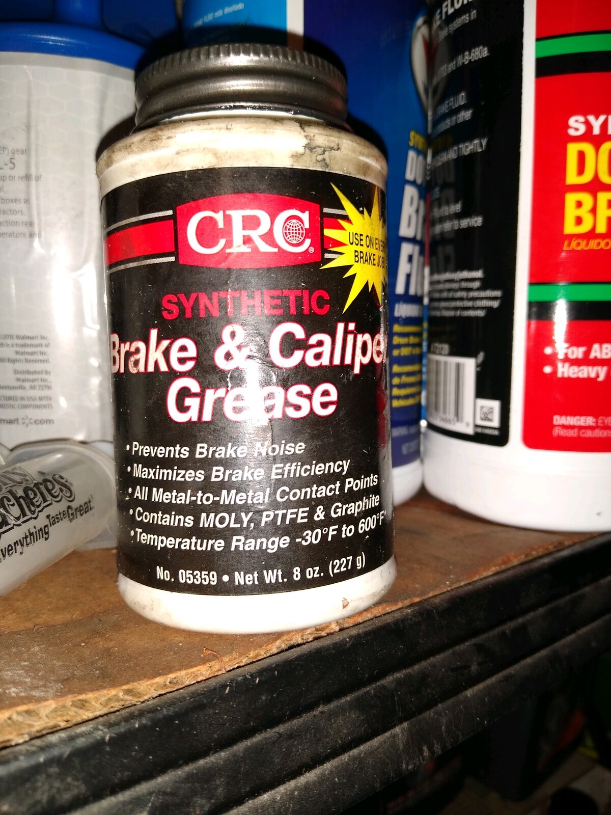

The hoses will sometimes fail and not allow flow when the pedal is released. Visually they look to be good. I suggest you replace both hoses. Also, what type of lube are you using on the pins?

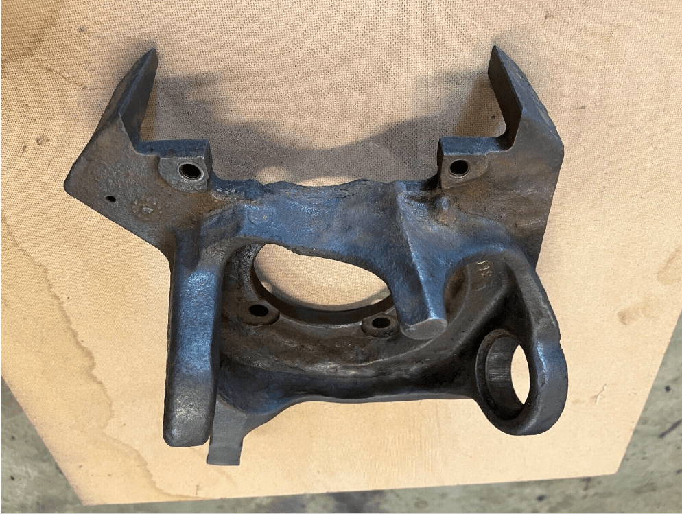

Good choice. Are you also lubing the flat surfaces where the caliper rides on the piston housing?
I apply grease onto the flat surfaces of the front wheel steering knuckle which interface with corresponding flat surfaces on the brake caliper. These surfaces are exposed to road spray and, therefore, don't remain greased for very long...

Those are the only two places that I apply lube to. I only lube them during the bearing repack process, every 50-60k miles.
My understanding is the caliper casting should be free to move/slide laterally on its slider pins and along the interfacing (flat) surfaces of the caliper and the steering knuckle.
The slider pins have bushings and I apply the grease between the pins/bushings as well as between the caliper/knuckle.
