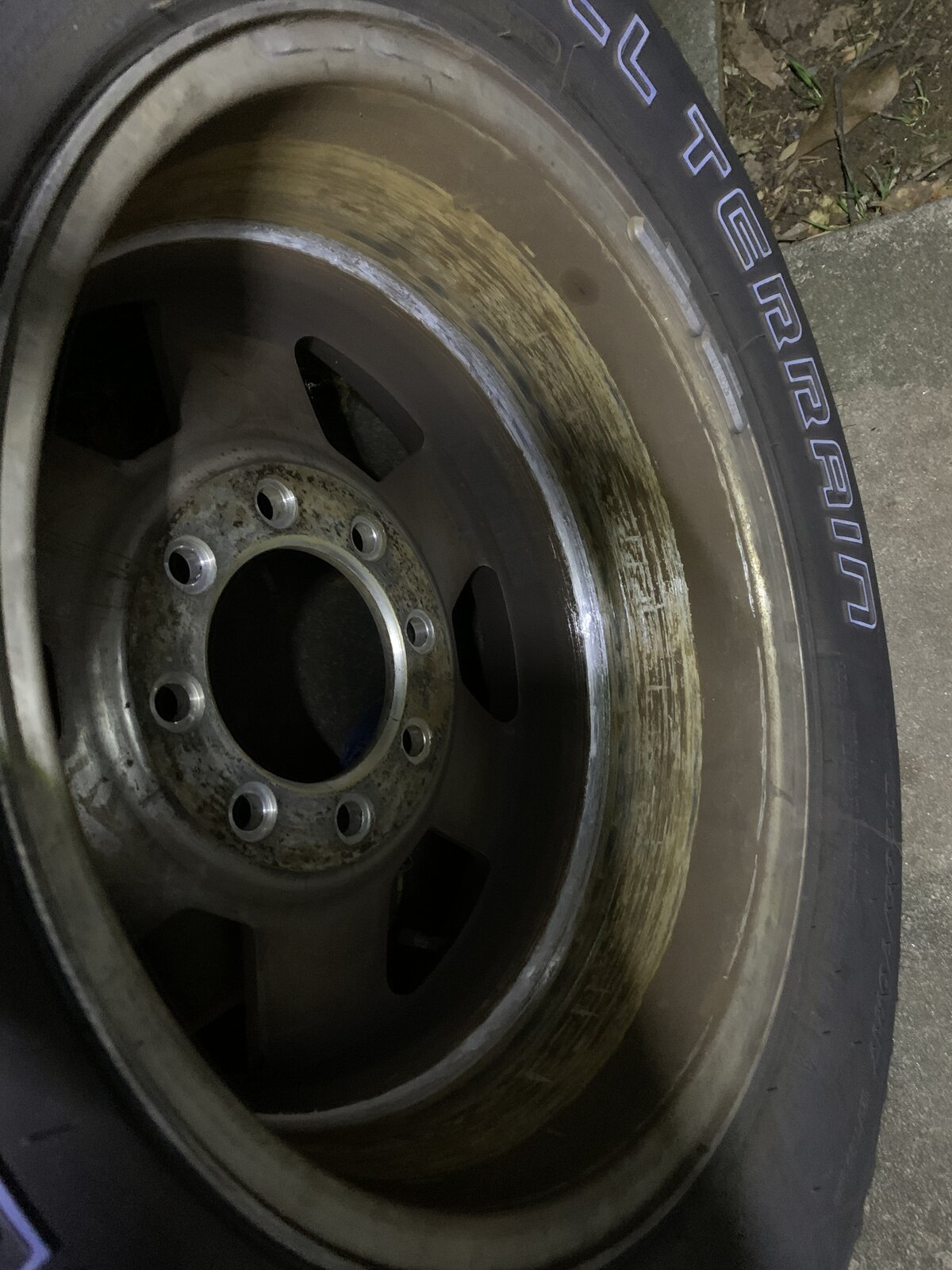

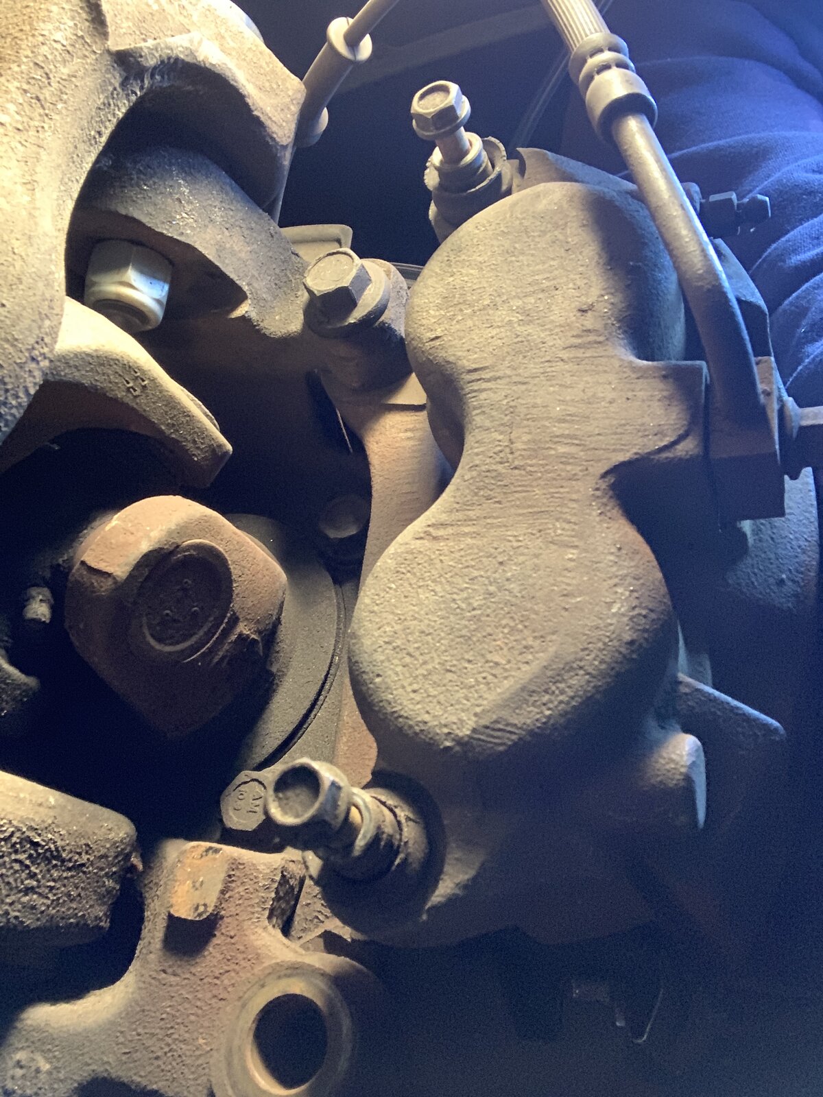

I went to test the truck brakes on gravel and as I stopped at 1st intersection. I lightly tap the brakes and the front right wheel, locked and skidded, leaving about a 32 inch skid mark but none of the other wheels locked up. What confused me is that with that right front locking up caused a major shudder, which seemed like the other three wheels were locking up. I jacked up the right front wheel and found the pads which I installed new last July ‘22 we’re fine and when I started to loosen up the caliper, the whole caliper pivoted up and I noticed the bottom bolt was missing from the caliper bracket as shown in the picture. This is not the 2-12mm bolts that hold the caliper to the bracket but it’s the two 18 mm bolts that hold the bracket to the knuckle (if I’ve got the correct terminology).
You’ll notice I loosened the 2-12mm caliper bolts to pivot the caliper out to check pad thickness. They looked new. What happened was when I applied brakes, the caliper pivoted off the top bolt and it ground into the soft aluminum of the wheel causing the violent shudder throughout the suspension making me think all brakes were locking. Luckily this happened a mile from home and was able to brake downshifting or use emergency brake. We experienced the same problem dropping a top bolt on the driver’s side last year but it was a top bolt and caliper didn’t pivot from the bottom like this one. My mechanic son said never had to Locktite other caliper brackets before but we will these. Thanks everyone for your input trying to solve this problem.
There is a red flag here. Caliper mounting bolts do not come loose and fall out. Adding Loctite to a fastener is usually a bandaid. This has happened to you twice. I recommend rechecking torque on all fasteners for any brake work you have done on this truck.
Mounting surfaces need to be clean and flat. The fastener and the threads of the part being fastened must be clean. The fastener may or may not need to be lubed (check FSM). Correct torque is a must. With the correct torque, the fastener will stretch to an engineered length and this stretch is what will maintain its clamping force, even with vibration and thermal expansion / contraction present. Proper stretch is what makes the fastener stay tight, not Loctite.

All sliding caliper bolts and caliper to knuckle bolts have thread locker from the factory. We use blue loctite on every brake and suspension fastener at the college and every fastener is torqued to OEM specifications. We do 3-4 brake jobs a day and it is amazing of all the different fastener sizes and torque specifications on the cars.
I was 1/2 mile from home when I experienced the brake lock issue and I typically try to anticipate a stop light and slow to a stop without breaking and was barely rolling at 10 mph so truck stopped in less than 3’ so I never really heard any scrapping, it was a lockup/shudder is all I heard. Went less than 20 mph for last half mile. I’ve already picked up new 12mm caliper slide bolts and rubber covers along with 18 mm bolt. Just need to get FSM recommendation for torque setting. Not gonna be easy to torque as I’m on jacks with limited swing of torque wrench but will get it right. Thanks again. I’m thinking I’ll check and relube and replace rubber slide bolt covers every 2 years now that I’ve seen what happened to the new ones I had on there from new rotors and pads installation
