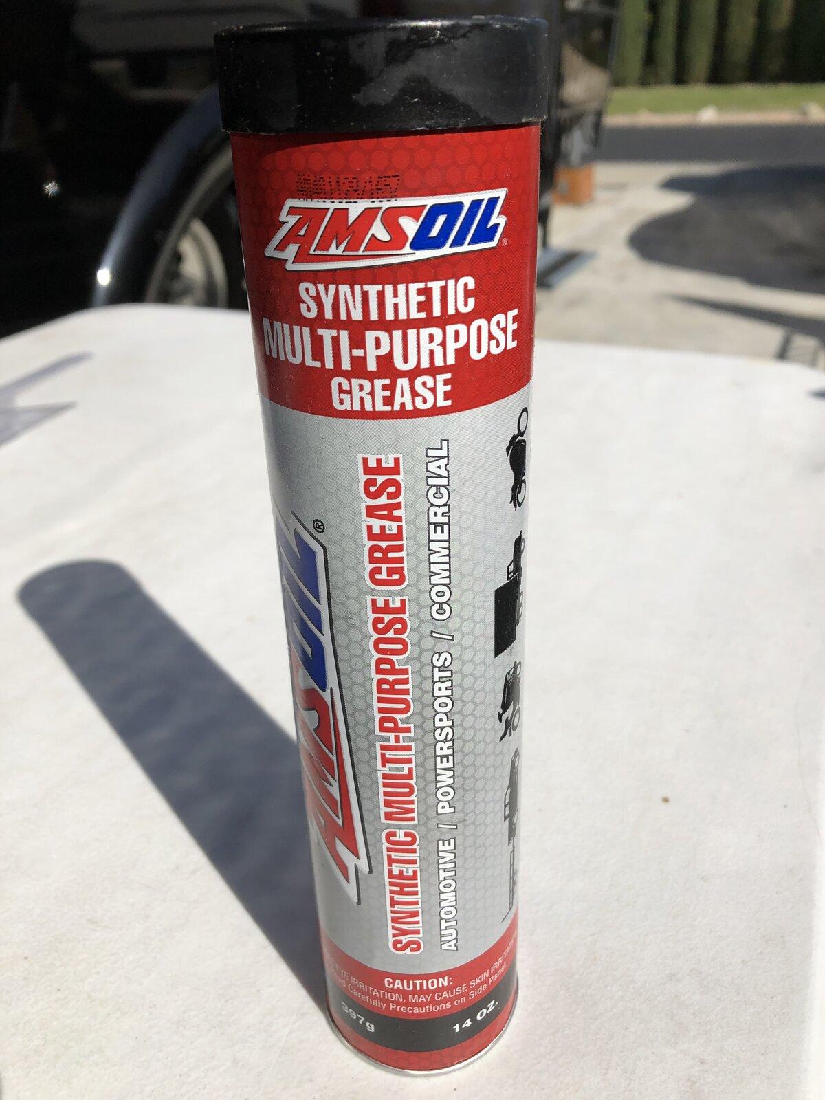

Shoot some wheel bearings grease in the ABS hole and see if it goes away, unless there was too much play.
I agree, what do you have to loose?
I am out of warranty at the end of this month so I think I will give mine a shot of this later this Summer.
GS, I appreciate that!
I may be wrong, but my old school mind says not to mix greases. I recall seeing some front wheel bearings and some steering components that an old tech at the shop showed me where the grease was "hardened". He said it was from mixing different greases. Just a thought.
You are correct. The thickeners used have been classically soaps or clays and mixing those would harden to basically concrete. Today there are so many blends used that you can't guess what you're mixing. Best to stay away from mixing at all.

Would this really be a problem with a synthetic grease? I thought that was why synthetic grease was developed to prevent these issues. Somebody have more knowledge on this? Would like to know for the truck and other equipment. Thanks for any updates.

Adding a little grease to the sealed wheel bearings seems like a good idea to me, time will tell thou.
Mixing synthetic grease has the same result. In my pre-retired life we maintained aircraft. Landing gear that had been lubed for years with clay based grease and then lubed with synthetic grease, were filled with hard concrete like chunks when disassembled.

I don’t think mixing grease is that much of an issue if you use good grease. Grease mixing happens all the time with greasable components that you pay to have serviced.
Good Grease? Most greases are good grease for the application that they were formulated for. The problem arises when non compatible greases are mixed. Usually there are two out outcomes. One has already been referenced. The incompatible greases harden and there is no lubrication. The second is liquification of the mixed greases and once again there is no or very little lubrication. Here is a place to start;
Grease Compatibility Chart and Reference Guide (machinerylubrication.com)
With that the question becomes "What were the bearings lubricated with initially?". I would feel comfortable with using a lithium-based grease that is formulated for disk brake applications. While we all feel good about using "synthetic" it may not be the better choice if it is not compatible. I know that I can get grease compatibility tests run at Chevron in Richmond, CA which is only about 45 miles from me by sending a sample of both greases to them.
All said, since the bearings are lubricated with the lowest bid grease that meets Dodge's?, Ram's?, Stellantis,?, spec I seriously doubt that we would ever be able to find out what grease, made by whom, was used. My bet would be that it was not a synthetic. Most likely a lithium high temp grease. I have not put any grease in my hubs in 207K and had no issues. I may try it and will use Chevron Delo Grease if I do (because I have a 1/4 drum of it and it is what I use on disk brakes).
