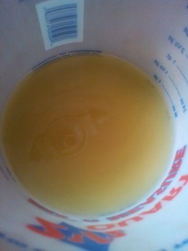

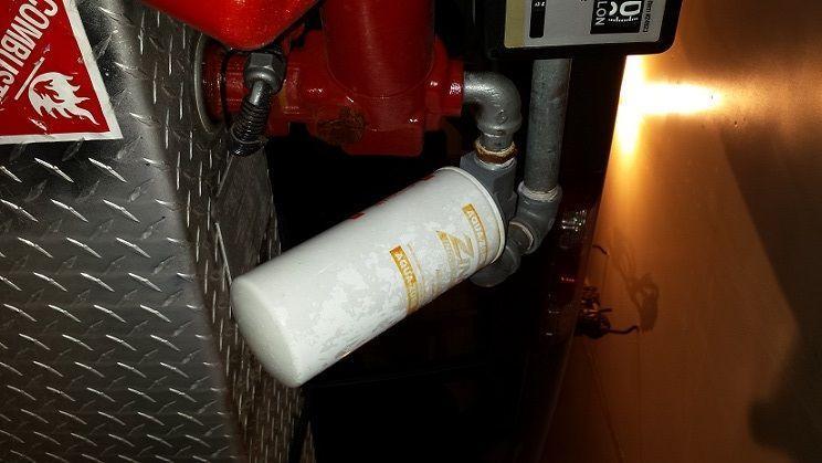

Yep. their the one I recommend, Even I suck up a pocket of bad fuel in June of 2013 at just a few hundred miles on my truck. the Zinga stop and plugged 100% stopping the contamination from Factory Tank. I had MNBlue suck My Auxiliary Tank dry, and We dip the Ground tank. In MN the Place to Buy diesel is SuperAmerica , Kwik Trip , After that its a crap shoot. All My diesel's are equip with Auxiliary filtration and lift system.

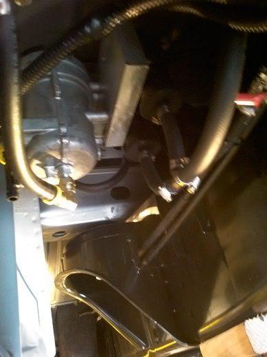

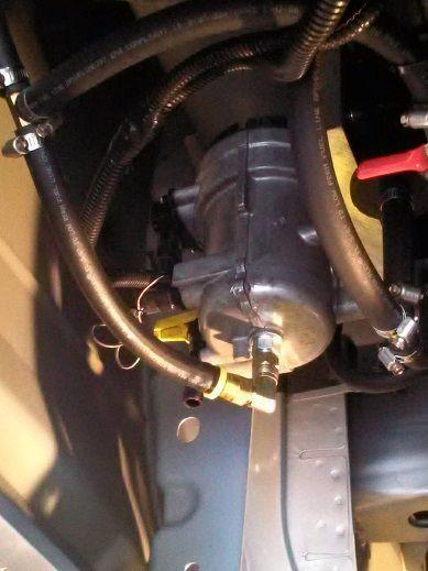

Okay, so I've got an auxiliary bed-mounted tank with a water-separator between it and the OEM tank. I only fill the auxiliary tank and gravity feed the fuel to the OEM. It looks like I need to replace the WS with a Zinga?
You'd have to do some research on their site, as the filters absorb water the media swells and slowly plug off to the point a high volume pump won't push fuel through. I'm not sure how gravity feed would work through them long term.
Also, they are spin on filters, mine is a 1-12 thread
